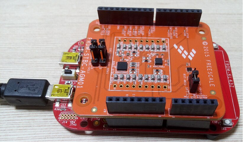

We are connecting
I2CSDA0 of STBC to I2C1SDA of KL43Z freedom board and
I2CSCL0 of STBC to I2C1SCL of KL43Z which are PTE0 (SDA) and PTE1 (SCL) pins of KL43Z board.
The corresponding 7-bit I2C slave address of STBC sensor board are
FXAS21002C is 0x20
FXOS8700CQ is 0x1E
The interrupt pins of the sensor are connected as follows:
INT1- 8700  > J1-6  > PTD3
INT1-21002  > J1-12  >  PTA5
I have enclosed the project folder and executables, download the project and open it in KDS IDE import the project to your current workspace.
Build the project and execute it.
Connect the sensor board to FRDM-KL43Z board as shown below:

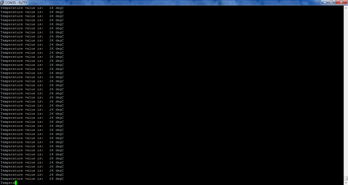

After compiling and executing the code you can see the output in an hyper terminal with baud rate of 19200 as shown below:
Mode-1 output window:
Mode-2 output (Accelerometer data):
Mode-3 output (Magnetometer data):
Mode-4 output (Gyro data):
Mode-5 output (Temperature data):
The executable are attached along with this to test at your end and the project folder for quick reference
