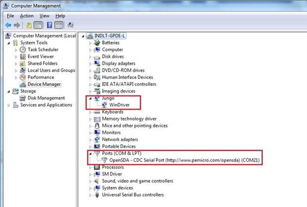

I cannot make my FRDM-KE02Z40M module communicate via its OpenSDA USB port.
e14 Contributor
I have installed the P&E driver.
Under the device heading of Jungo, I am supposed to see two devices "WinDriver",
and, "PEMicro OpenSDA Debug", but I only ever see the former.
When I run the Basic "GDB Server Kinetis", and I select the
"OpenSDA  Embedded Debug - USB Port" interface, I see no Port in the
Port drop down menu.  But, in Device Manager, I see a port called
"OpenSDA - CDC Serial Port (http://www.pemicro.com/opensda) (COMx)"
The COM port number varies, depending on how many times I install, uninstall, and so on.

    FRDM-KE02Z comes with the MSD Flash Programmer OpenSDA Application driver preinstalled with "MSD-FRDM-KE02Z_Pemicro_v111.SDA" through which you can only test with pre-compiled example binaries which are in *.srec file format, but you cannot debug the board.
    with MSD application driver you might have seen below screen shot of device manager as shown

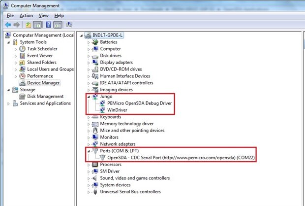

    You are now running the board in Debug mode and device manager looks as below:
    Now you can see  two devices "WinDriver",and, "PEMicro OpenSDA Debug" under Jungo.

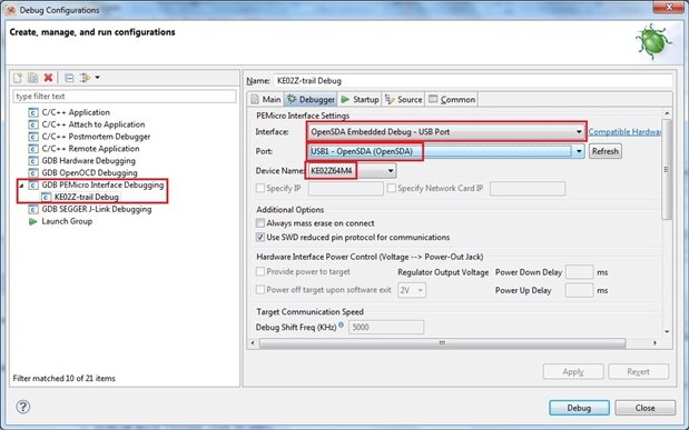

    Now in KDS tool you can configure the board in "Debug configuration" window under "GDB PEMicro Interface Debugging"  it looks as shown below screen shot.
    The OpenSDA Embedded Debug USB port gets recognized.
