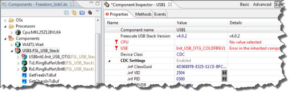

This will add the components to my project. And the USB component shows a red (x) telling me that it needs to be configured:
Need to configure the FSL_USB_Stack
I need to component Inspector to configure the properties.
:idea:  Idea: The context menu ‘Inspector’ on a component opens the Component Inspector View.
If I inspect the properties of the USB component, it shows me that I need to set up the CPU and the USBInit property:
Need to configure component
So I select the CPU for my KL25Z board, and select Init_USB_OTG_VAR0 to initialize the USB peripheral for it:

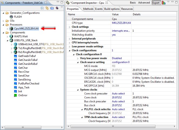

The configuration of the clock is in the CPU component. For this I select the CPU to configure the properties:
CPU component to configure the clocks
I can have multiple oscillator settings, but here I just need one. So I enable the ‘System oscillator 0′ setting, and configure it to use an 8 MHz external crystal in High gain mode (for the white pre-production board which has the R25 (see above) populated, but in Low Power mode for the black production board:
Setting 8 MHz external crystal with High Gain (White board only!!!)
As the black Freedom board has no R25 populated, the Oscillator operating mode has to be ‘Low power’ instead:
Low Power Oscillator Mode required if R25 not populated (black Freedom board)
Next is to select the PEE (PLL Engaged External) clock mode: in this mode, the PLL is using the external reference clock. Remember that the USB block needs an 48 MHz PLL signal? So I need to configure it to 96 MHz as it will be divided by a factor of 2 until it reaches the USB block:
PEE MCG Mode
