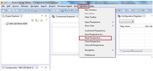

You can see a KDS project window created for our New project. To see a relevant perspective windows click on ‘Windows>Reset Perspective’ as shown below:
You can see below updated project window and is created and ready to include the source code.

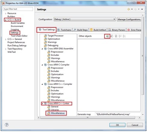

Next we need to add the KSDK library in the compiler, this step is very important else u will not be able to compile your project.
To add this you need to right click the project and click in "Properties".
select "C/C++ Build" menu go to "Settings".
Then click on “Tool Settings” and select "Miscellaneous" under "Cross ARM C++ Linker" option as shown below:
Click on add object button    as shown above and add the library here.
The default path is "C:\Freescale\KSDK_1.0.0\lib\ksdk_platform_lib\kds\K64F12\Debug\ksdk_platform_lib.a".
And proceed further
