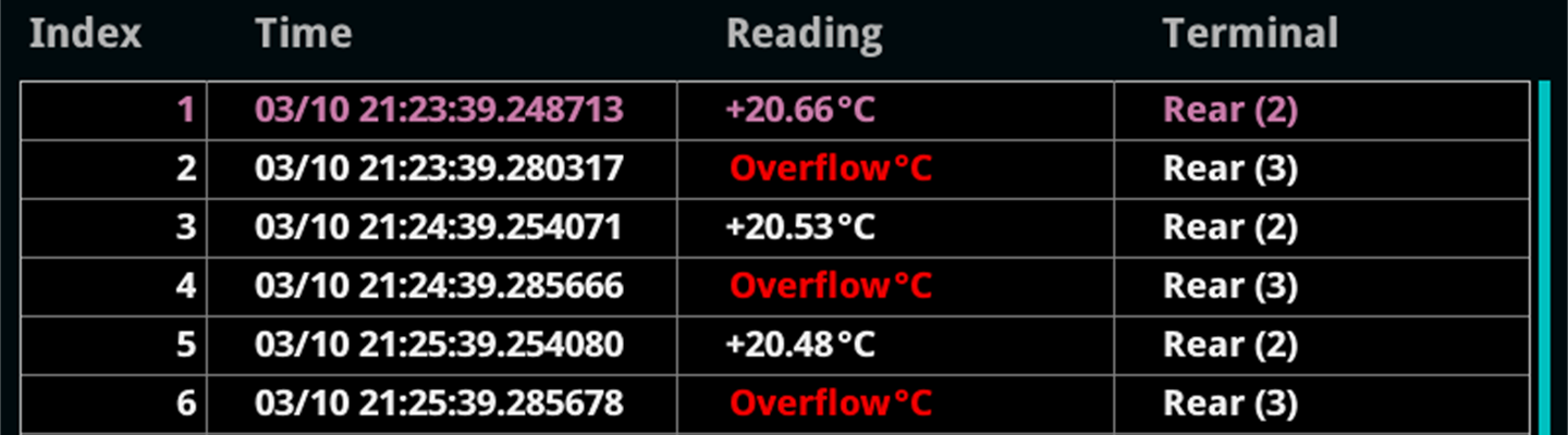

I've defined the script to scan channel 2 and 3 - even though nothing is connected to channel 3. It will overflow.
I sample 2 channels to learn myself how to do multiple measurements. In hindsight, I should have bridged CH2 and 3 on the card, so that I'd have valid measurements.

Here's a view of the results. Channel 2 and 3 sampled 3 times.
All samples are visible in the buffer display on the screen, and I read the 2nd sample of channel 2.
Channel 3 measures are in overflow because I didn't connect a thermocouple

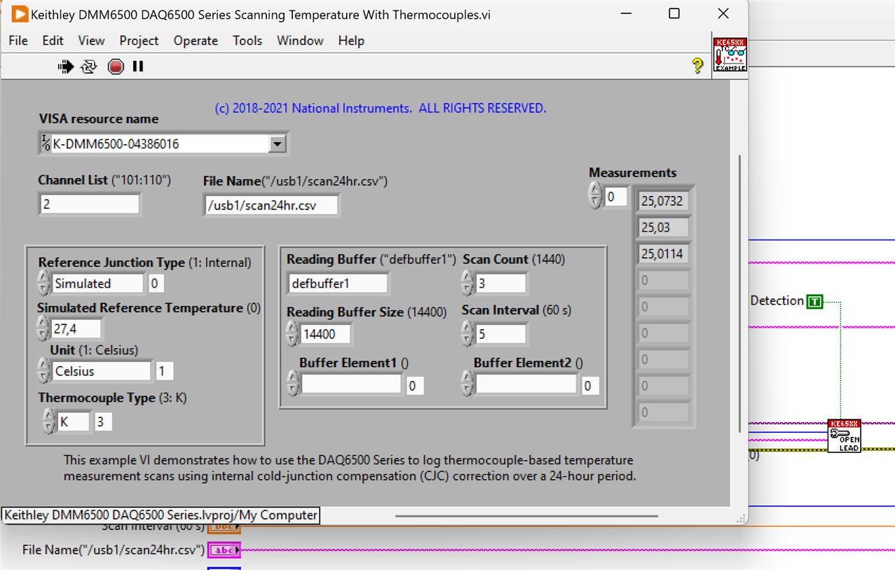

    The second blog, where I review this flow in LabVIEW, will be easy. Keithley has added this as an example to their driver.
    Here it is in action. I just added the field to enter the simulated value.
    For the time being, I'm measuring the temperature at the cold junction with a DMM, and enter that in the simulated value field.
    Accuracy will come later, when I install the PT100 on my scanner card.
