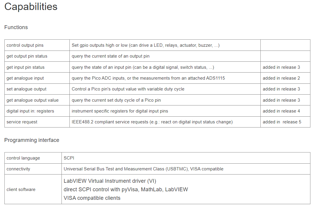

This challenge is unique, since as far as I know this is the first of many kind can brings affordable sensor end with PICO SCPI Labtool.

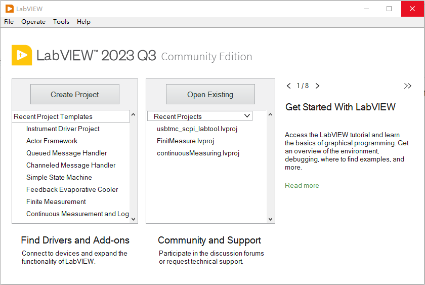

The fist this is to download and install Labview Community Version, it is easy once you have one NI account. There are cluster of programs to be installed if you like, but without licence they can not start. As I have mentioned before, this bundle is stong enough and worth the price. Mastering these tool with test-pass certification can be sought-after ability by clients. So start the labview

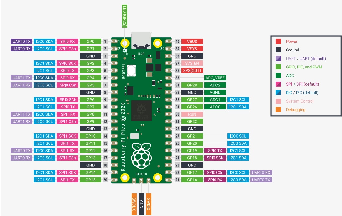

Then make one Raspberry Pi PICO ready with  SCPI Labtool firmware flashed.
Then understand and familiar with PICO SCPI Labtool and how to use it.

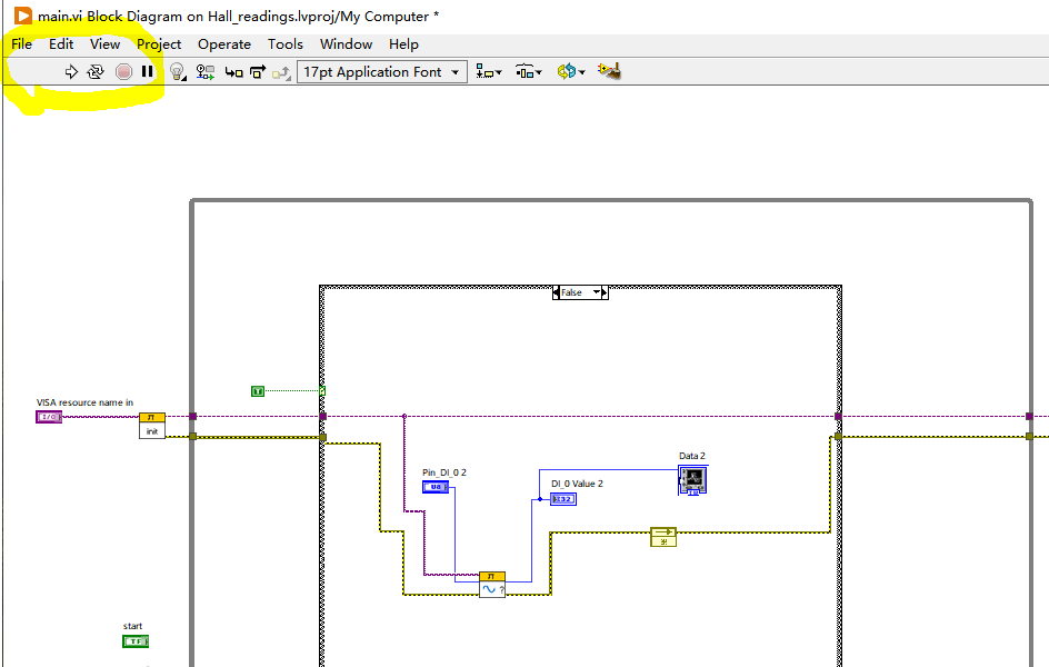

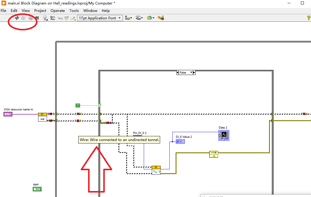

There have been reading document on how to use labview, but the best guide is to try and test. The knowledge matrix is complex, one have to go layers by layers to find the applet sub-VI to be used in coding. But the best part of labview is that it can be self guide and prompt errors with UI popup to find it. Start from correctly running code, noting the yellow part.
It add one wrong wire, noting the logo in read oval which report wrong instantly and prompt the reason in docking label once mouse move over the wrong wires.

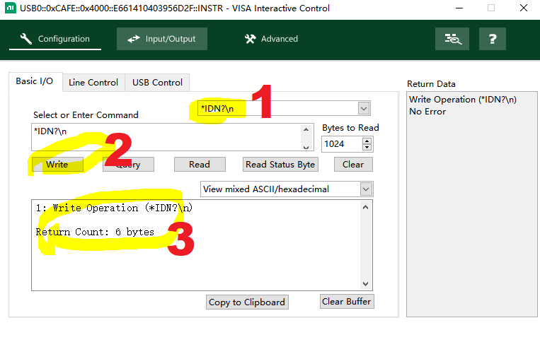

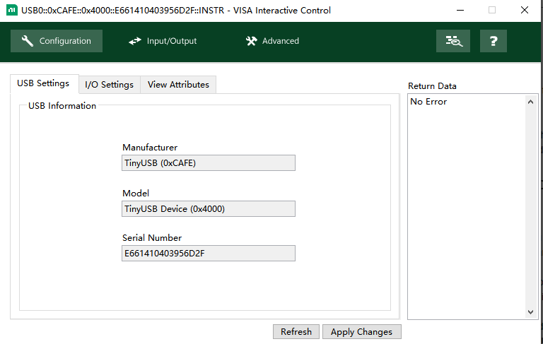

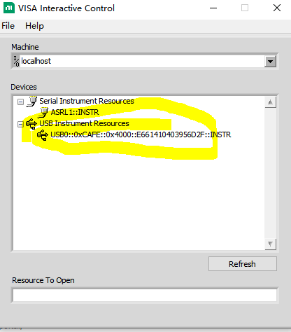

Thanks to hardwork of TOP members, the idea  SCPI Labtool can be shorten to one bridge, one part runs on host compter, mimic one VISA port, can be access with NI VISA interactive control portal,
Double click the USB Instrument Resouces USB0:xxxxxxxxx, this is the Raspberry Pi PICO , parameters shall be
Do 1-2-3 as follows repeatly with different SCPI script, one can access Pins in Raspberry Pi PICO
The other part is firmware of Raspberry Pi Pico, it is bridge, get the script from host computer like
*IDN?\n
Then parse the code, bridge the command to ports as read/write, digital/analogue,
Then binggo, the Raspberry Pi PICO is transparent, as if it does not there, the host computer control the ports.

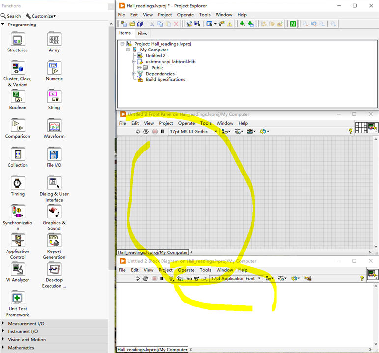

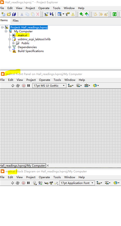

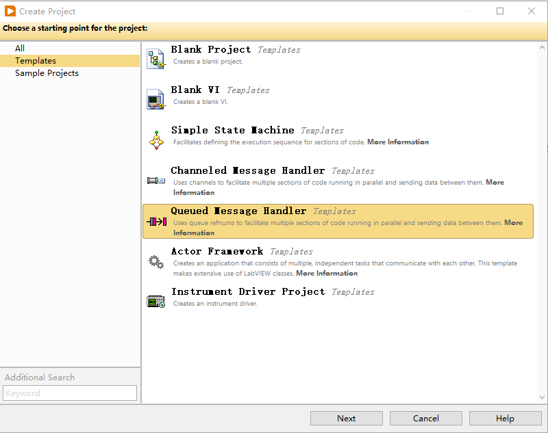

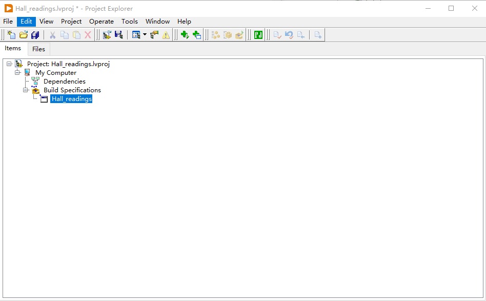

The design of Labview is creating and editing VI, create VI with blank project, of course, some sample project can be very useful as reference,

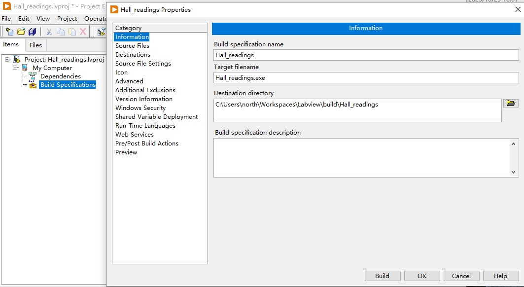

Press save and name the VI instead of Untitled, the VI can be compile to standalone runtime exe file if configuration build specifcation first,

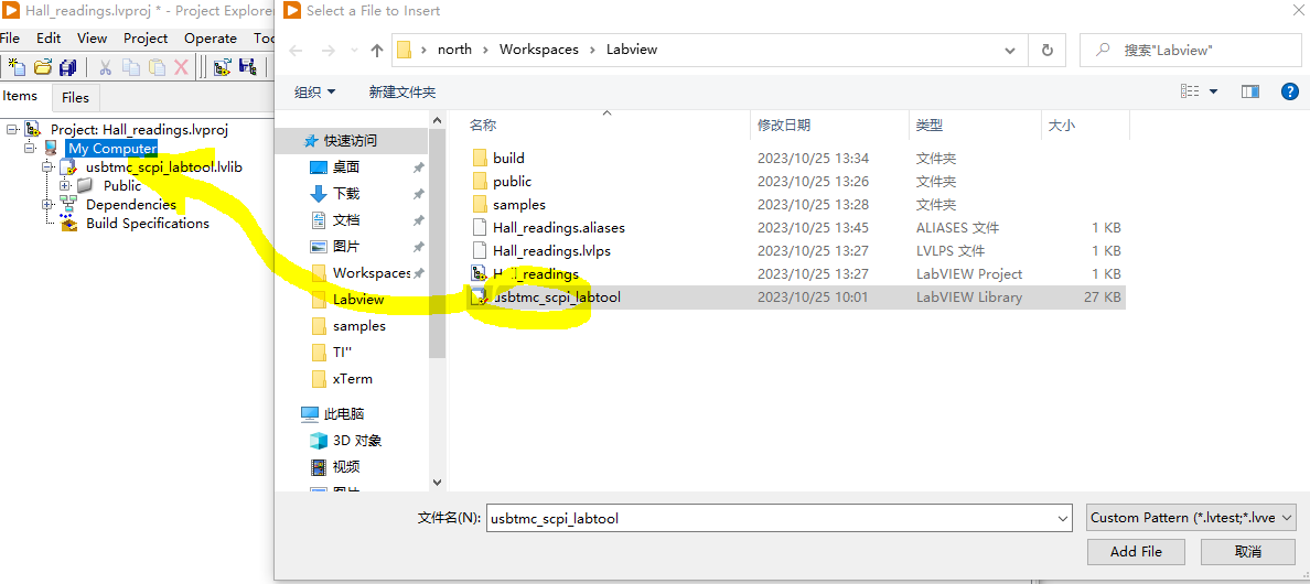

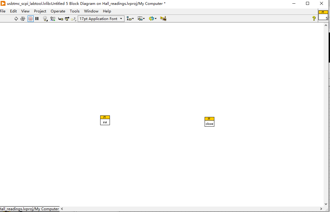

Add the SCPI labtool library first,

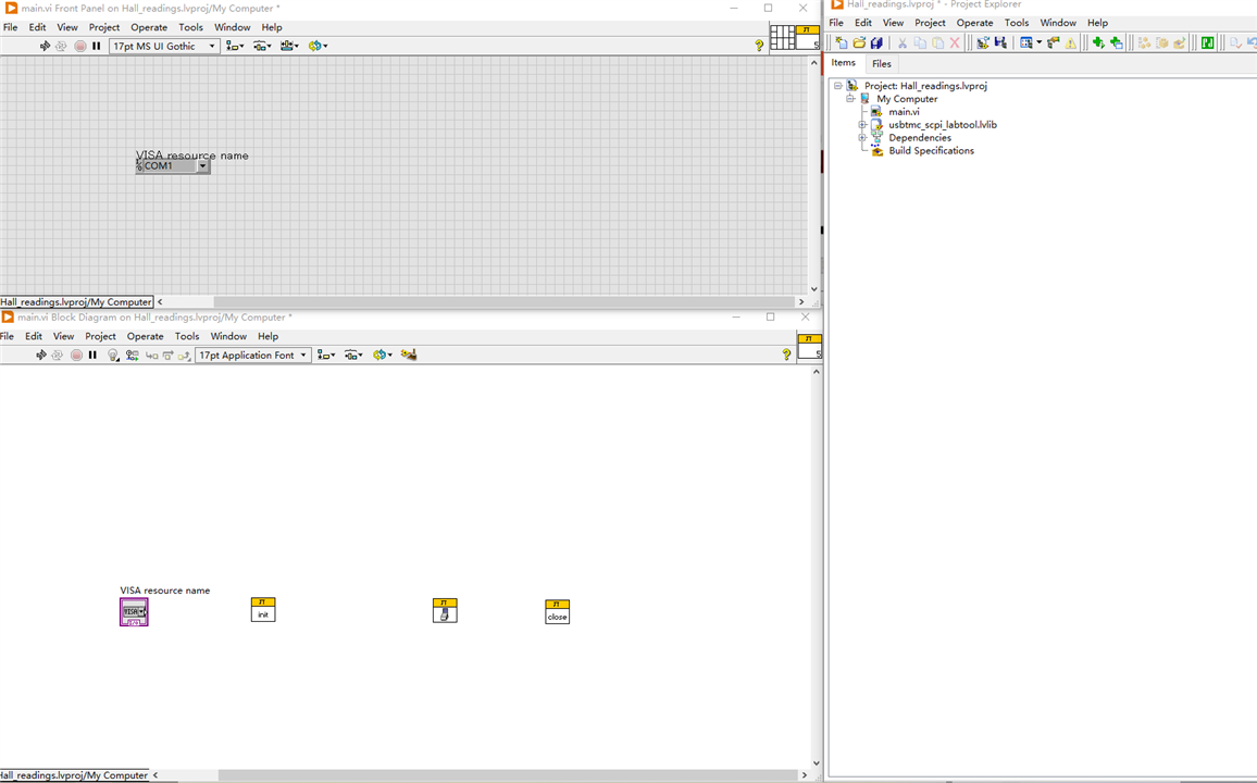

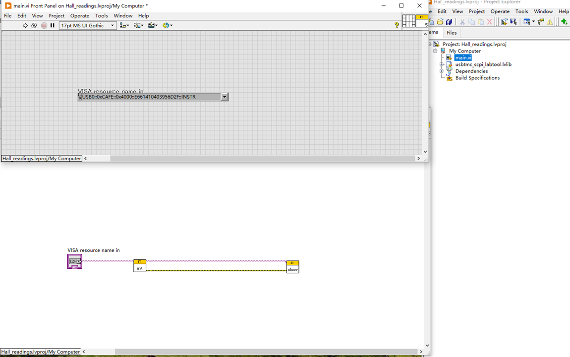

And create one VI as main.v as entrance VI, the function panel and front panel popup.
save to change name to main.v

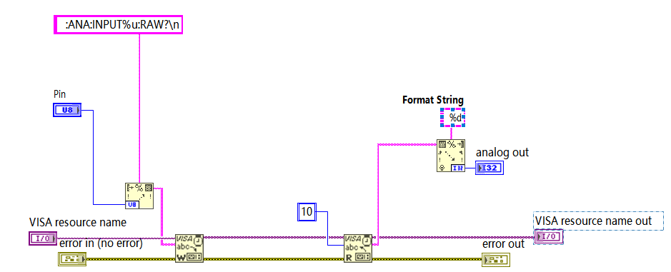

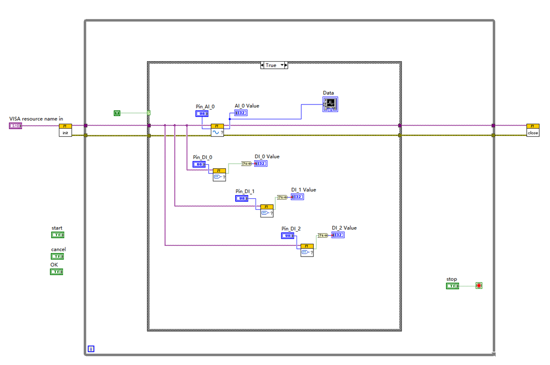

add functions and sub-VI one by one in front panel , for SCPI labtool, the Init and Close shall be put first with search VI
add VISA component In, this is where the USB0 resource come in,
Wire them accordingly, the following is basic program , doing nothing, but form the framework of this design.

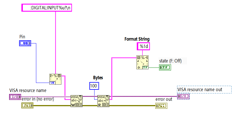

Complete the fist design with reference to example digital read out,

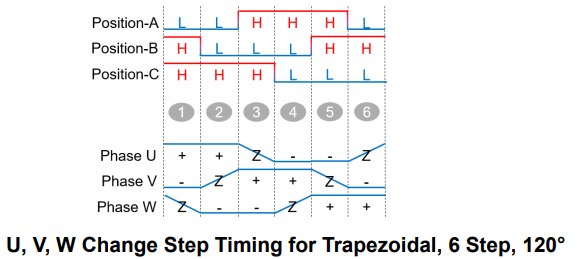

As planned, add more pins from digital input from BLDC hall sensor and analogue input from Hall sensor board,
Revise the design

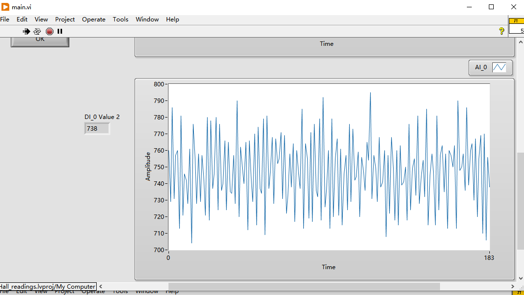

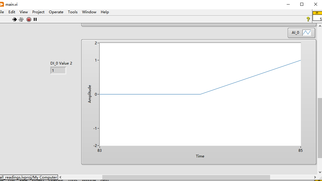

Start the VI, the front panel, show the three Hall sensor reading while the BLDC turns ,
The sequence shall be as blow, marking the position of rotor,
Then the digital reading from BLDC Hall sensor in X-Y plotter
Then the analogu reading from Hall sensor in X-Y plotter
It works fine.
8 Conclusion
This final blog can brief  outline how Raspberry Pi PICO run with SCPI labtool in NI labview environment, it is perfect. The reading of hall sensors mark the angle position of rotor, with the span time period, the running of motor in RPM can be calculated.

    1. The True/False case structure is temporary Position Holder for revision. Constant True/False as input for case during debugg. Some buttons are not in used in this VI design. It would trigger case selection as input.
    2. The error control is very important, in case dead loop or I/O errors happen.
    3. The labview structure design is very flexible, Even empty structure help a lot in objective orient design.
  • Andrew J
    Andrew J over 2 years ago
    Good job, I like that you’ve used the charting/graphing controls. If I could make one comment: you have a case structure with your code in the true case and a true Boolean wired to the Boolean.  That means it always runs of course so really, the case structure isn’t needed.  However, what is normally done is for an error control to be wired to the case conditional so your code only runs when no error is present.  Wire the error out of the Visa init vi to the case conditional so your code only runs when the init has no errors.  There are additional things you could do with the error flows but that would just be tidying up loose ends.
