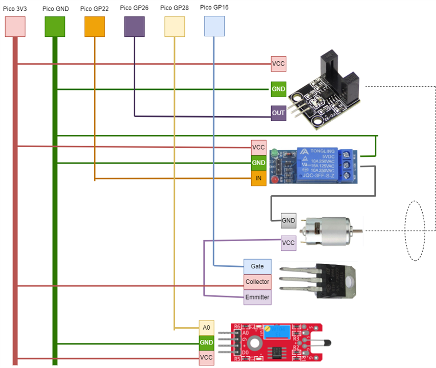

Introduction:
As my final project, I am making a dc motor rpm monitor & control system using pi pico & labview. DC motor rpm will be temperature controlled. The motor rpm will keep decreasing as the temperature increases. If the temperature crosses a certain threshold, it will trip the circuit & the motor will stop.
Components Used:
  • Pi Pico
  • Labview
  • 3v DC Motor
  • Relay Module
  • HC-89 Interrupt Sensor
  • TIP122 NPN transistor
  • KY-028 Digital Temperature Sensor (will be using analog pin)

To be able to change the motor rpm, I am using a transistor as a switch which will turn on/off rapidly to control the supply voltage to the motor. For 3v supply, I am using the voltage pin of arduino. For switching, I am using the PWM in the pi pico. The VI is shown below:
The duty cycle needs be passed in %. The subsequent logic will convert it to a real number in range (0, 4095). 4095 corresponds to highest duty cycle i.e. 100%.
I couldn't check & verify the pwm pulses generated as I don't have an oscilloscope Sweat smile. But I checked the output dc voltage value on pin 0 (i.e. GP16) in a digital multimeter. At 50% duty cycle, it shows 1.64v & at 100% it shows 3.27v. So, I think it should work.
I connected a MOSFET (TIP122) between the motor and the supply. As can be seen in the video below, the motor doesn't start unless the duty cycle is >75% but once it starts, I can reduce the duty cycle to control its speed.

This is the last step. Since we can now control the motor speed using duty cycle, we are now going to control the duty cycle with temperature. To emulate high temperature, I am using an electric iron. As the temperature increases, the sensor data decreases. When it reaches below 550, the relay disconnects the supply and the motor stops.
Final Video:
The motor doesn't work properly, so I had to push it a little bitSweat smile. I guess that is okay.
Circuit Diagram:
