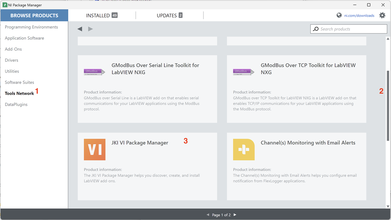

Install LabView 2023 Community Edition.  Nothing special here: download the installer, run it, follow the prompts. I'm installing into a Windows 11 VM on my iMac as my preference is to keep these tools in their own, managed environment especially as it's a big install.  There are versions for MacOS and Linux.  Check also that it installs the JKI VI Package Manager (VIPM) as well which is needed to find useful plug-ins; if not, run the NI Package Manager and search for it in the "Tools Network" category:
Screenshot showing the NI Package Manager application positioned to install JKI VI Package Manager
When I ran VIPM the first time it asked me what version I wanted to install.  Given I didn't need a paid license, my choice was the "Free" version although the "Community" version would also work.  The latter is best suited for packaging and sharing Open Source applications in the JKI community and not something I intend to do.  The only thing not totally clear is the licensing: reading on their web page it would imply that "Free" is for Academic and Commercial purposes for finding and downloading (but not packaging) but is free for LabVIEW users.  Sort of implies I both fit and don't fit the terms and I never received an answer to a query I raised about it.  Given I only intend to download free to use packages I think I'm ok.
The reason for checking it is installed, or doing so, is that Packages seem to form a key means for adding additional functionality and tools into LabVIEW from other providers.  I'll show how it works below and may find myself using it later in development if there are tools that will help me.
