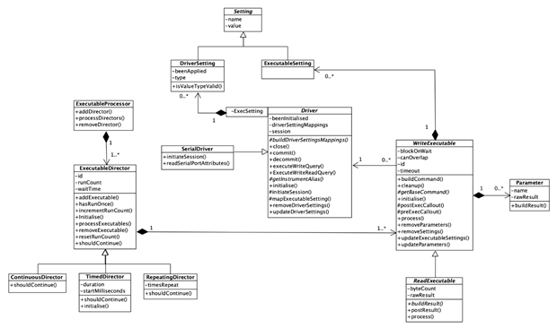

Note: The diagrams below are intended to show main classes and methods and are not a complete picture of the framework.

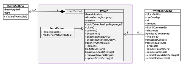

The class diagram above shows the classes and relationships that form the core element of the framework.  I'll break it down into smaller sections.

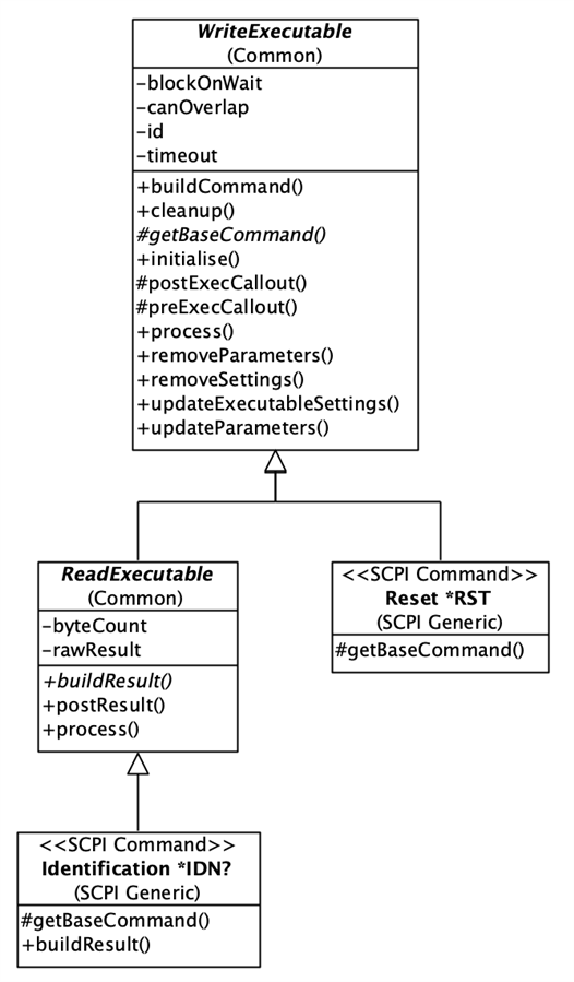

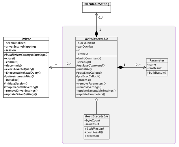

Executable
An Executable represents a command that can be sent to a Driver for running on an instrument.  As the framework evolves over time, these will become much more than just commands for Drivers, and will represent other execution constructions such as optional pathways, or directives to help with processing.
There are two types of Executable:
  • WriteExecutable: represents a command that can be sent to an instrument but which requires no response.
  • ReadExecutable: represents a command that can be sent to an instrument and for which a response or result will be returned.  You will note it inherits some of its functionality from WriteExecutable: you don't need to run a Write Executable *and* a Read Executable as the latter incorporates the functionality for you.
An Executable is associated with a Driver whose responsibility it is to undertake any instrument specific translation of a command.  The framework will arrange for the Driver to run the command at the appropriate moment.
There are two ways a Driver can run an Executable:
  • Immediately: as it says - the Driver sends the command straight to the instrument.
  • When able: in this case, the Driver will wait for the instrument to finish processing any existing commands before sending this one.
An Executable controls this with its canOverlap property: if true, the Executable will be run immediately; if false, when able.
A ReadExecutable will hold a result returned from the instrument.  It does so in a raw form, rawResult - that is, it provides no interpretation of that result until asked to do so by the test application calling buildResult.  The test application will be notified of an available result via a result message raised on the Notification queue or a raised Notifier.  The result data is the same in both cases: the Executable itself is passed back to the test app and can be used to obtain the results as a raw value (String) or a typed value.
Executables can take parameters to send along with the base command.  These are represented by the Parameter class.  The framework will automatically add any requested parameters to the command before it is sent to the instrument: you just need to add the ones you want to the Executable when you create an instance of it.  A Parameter will hold a result, if available, and is capable of parsing that into a typed value for the test application.

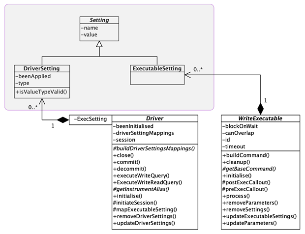

Executable Settings are a way of provisioning configuration settings for Drivers, independently of how they may be applied to an instrument.  For example, you might use an Executable Setting called 'Settling Time'; on one DMM it might equate to 'Settle Time' whilst on another it might be 'Settling Duration'.  You won't care - the driver will map these to instrument specific configurations.
You'll see from the class diagram that Executable Settings provides no specific behaviour so is really just a placeholder.  There is more information in the Settings section below, but the functionality for settings hasn't needed any specific behaviour for Executables in the current version.
So what do you need to do to use the framework?  Basically, just use one of the existing Executables and add it to an Executable Director.  If none of the existing Executables are of any use, then create your own by following the pattern established by an existing one.
Here's an overview of two Executables:
You can see that all is needed is a concrete implementation of getBaseCommand (the command as it appears without any parameters or end of line characters) and, for Read Executables, a concrete implementation of buildResult which parses a raw result into a useable format for the test application - if the usable result is a string, this can just return the rawResult.

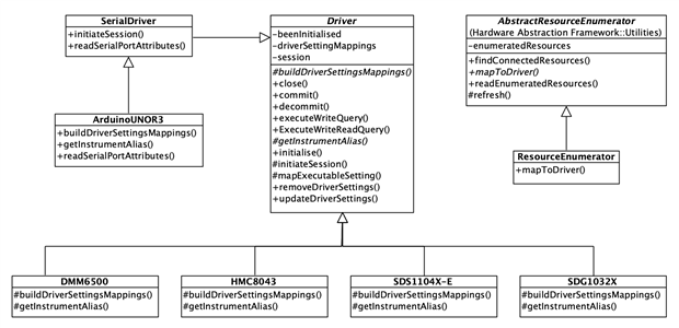

Driver
Driver is responsible for interfacing with actual test instruments providing the necessary mappings between a generic test language and instrument-specific language.  By doing this, a user of the framework can standardise on names for things like commands, parameter names, setting names and so on and leave the Driver to translate on an instrument-by-instrument basis.
SerialDriver should be used for instruments that will use a Serial communication method, e.g. Arduino Uno.  This operates the same way as the standard Driver but expects a device to be available on a mapped COM port rather than on, say, a USB port.
It is envisaged that future versions of the framework will be able to load mappings between the generic and specific from an external source to allow tests to be more configurable.  Lack of reflection in LabVIEW NXG makes this problematic at the moment.
A Driver will execute a query for an Executable when directed by the framework, obtaining a response as necessary.
Driver Settings are configurable items for an instrument and are mapped between a generic Executable Setting and the instrument setting.  More information is available in the Settings section.
So what do you need to do?  When you instantiate an Executable you need to give it a Driver to be used to process it.  It's likely you will need to create your own Driver instances but examples are available to draw from:
You can see here that all you need to provide is a concrete implementation for buildDriverSettingsMappings and getInstrumentAlias as the framework handles everything else.
The Arduino Uno Driver also provides an overridden readSerialPortAttributes because I want to communicate with it at 115200 baud, rather than the default 9600 baud, and I need the initialisation to wait 2000 milliseconds after opening a port to ensure the Arduino will be available to process commands.
These concrete Drivers are available in namespace Z_Implementation.

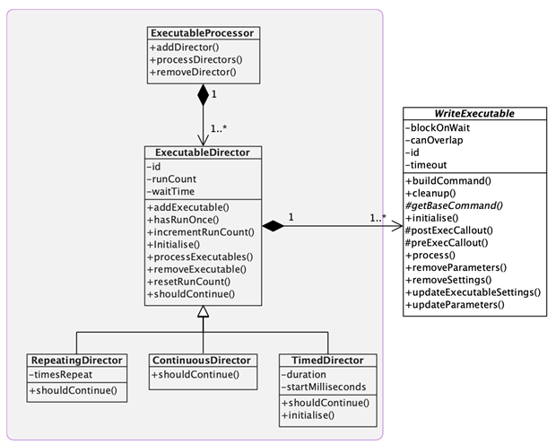

Processing of Executables is performed through ExecutableDirector instances and an ExecutableProcessor instance.
  • ExecutableDirector: The ExecutableDirector controls the processing of one or more Executables. Each Executable is processed at least once and depending upon the choice of ExecutableDirector, multiple times.
    • ExecutableDirector: processes each Executable once only.
    • RepeatingDirector: processes each Executable timesRepeat times.
    • ContinuousDirector: processes each Executable continuously until ordered to stop.  Your test application can do this by raising a stop event.  You could abort the running VI but this may leave the instrument in an unknown state (recover with a Reset Executable in the next test run.)
    • TimedDirector: processes each Executable for a minimum period of time.
An ExecutableDirector can hold more than one Executable and each Executable is processed in turn in the order loaded.  A processing run for an ExecutableDirector is 'every Executable', so Stop and Pause orders (via events) are acted on at the end of a run (actually, at the start of the next run if there is one.)  For the TimedDirector, the duration is a minimum amount of time because a processing run will be completed once started; note also that a Pause order does not stop the clock and the duration paused counts towards the overall duration.
waitTime is a duration in milliseconds between processing of each Executable.  So with a wait time of 10ms, and three Executables, processing will be Executable1-wait 10ms-Executable2-wait 10ms-Executable3.  For a TimedDirector, this wait also counts towards the processing duration.
  • ExecutableProcessor: This is the framework's main control processor, responsible for processing all ExecutableDirectors.  You only need one instance of this and processing starts by calling member processDirectors().  The ExecutableProcessor listens for Stop, Pause, and Resume events, acting accordingly on the ExecutableDirectors.  Although not a member property, processDirectors() takes a waitTime as a parameter which acts the same way as waitTime on the ExecutableDirector, except the wait is between Directors not Executables.
You select the ExecutableDirector(s) you want and add them to the ExecutableProcessor.  Thus you can mix-and-match the testing you want.  For example, you could load a Reset Executable into a ExecutableDirector, followed by a Measure Executable into a ContinousDirector.  This would then reset the instrument and continuously perform a measurement.
You should have no need to create an alternative ExecutableProcessor but you may want a different ExecutableDirector.  Create this as a subclass of ExecutableDirector and implement shouldContinue() (return true if processing of Executables should occur again) and if necessary initialise() if the ExecutableDirector needs any setup (for example, the TimedDirector sets its startMilliseconds property in initialise() so it can determine when the duration has elapsed.)
Note that a Pause event will be acted upon but it will timeout after 60 seconds regardless of whether a Resume event is raised. This is to prevent Instruments just 'sitting there' and the pause event is not intended for long term interrupt of Executable Processing.

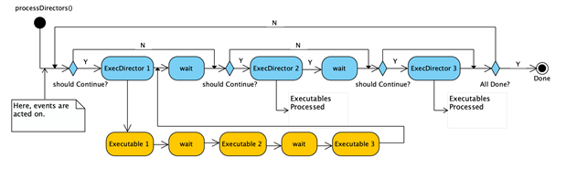

Processing Loop
The flow diagram above shows the high-level processing when processDirectors() is called on ExecutableProcessor.  This is all under the control of the framework of course, you just need to instantiate the necessary ExecutableDirectors and Exectubles.  Note that ExecutableDirectors can finish independently of each other and are ignored in any subsequent run through.  For example, in the above image, if ExecDirector1 was a TimedDirector of 1 minute; ExecDirector2 was a ContinuousDirector; and ExecDirector3 was a single-shot Director (ExecutableDirector instance) then:
* All will be processed in the first run through
* In the second run through, ExecDirector3 will return false for shouldContinue() so won't run anymore
* In the third and subsequent run throughs up until 1 elapsed minute, ExecDirector2 and ExecDirector3 will run;
* In runs after 1 minute, only ExecDirector3 will run, and will continue to do so until told to stop.

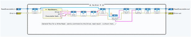

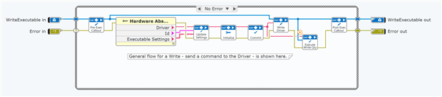

So what happens when an Executable is processed?
Write Executable
  1. Pre Exec Callout: run any Executable specific code before the Driver runs the command.
  2. Update Settings: add any new ExecutableSettings to the Driver, which will map them to DriverSettings
  3. Initialise: tell the Driver to create a session to the Instrument if one doesn't already exist (they are re-used once established)
  4. Commit: send any unprocessed DriverSettings to the Instrument
  5. Execute Write Query: send the command to the Instrument
  6. Post Exec Callout: run any Executable specific code after the Driver runs the command.
