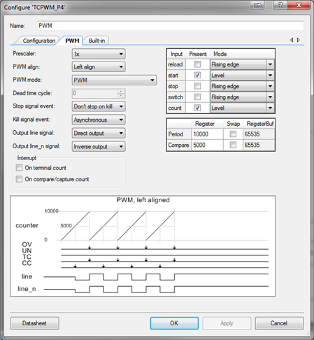

    Hi Dev,
    did you remember to setup the PWM Component configuration correctly?
    like so -
    PWM Component Config

    cy.gul over 12 years ago in reply to e14 Contributor
    Dev,
    attach your project here, I can try and take a look at where you might be going wrong.
    Edit - i just noticed you already posted your project, I'll take a look soon. brb
  • cy.gul
    Hi Dev,
    I found the source of your issue -
    The main.c file in your project needs to lines of code to 'start' the hardware Components.
    All Components in PSoC need to be explicitly started with a simple API. This is provided so the user can have complete control over all of the hardware Components and chose when to start/stop them.
    PWM_Start();
    Clock_Start();
    Place these 2 lines in the initialization section on the top of your main.c
    This is what your entire main.c should look like -
    #include <device.h>
    void main()
        /* Place your initialization/startup code here (e.g. MyInst_Start()) */
        Clock_Start();
        PWM_Start();
        /* CyGlobalIntEnable; */ /* Uncomment this line to enable global interrupts. */
        for(;;)
            /* Place your application code here. */
    e14 Contributor over 12 years ago in reply to cy.gul
    Yes...it's now working...
    I didnt aware about editing in main file.I will take care next time,
    (where can i get info about this kind of syntax for programming,I mean is there any guide on Cypress site or so??
