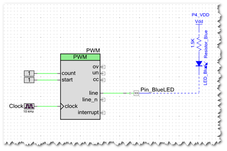

To kick-start our 100 Projects in 100 Days community effort around the PSoC 4 Pioneer Kit, today I'm posting a simple "Blinking LED" project.
This is a very simple project that will help you get started with your first design for the PSoC 4 Pioneer Kit.
Project Schematic:
                    Actual screenshot from PSoC Creator schematic (TopDesign.cysch)image
In this design, a PWM Component drives the Pin Component which is connected to the Blue LED on the Pioneer Kit. The PWM modulates to make the blue LED blink at regular intervals

    Hi,

    Where would you have  defined what connects to the count, start and clock pins on your schematic that you've shown? (I don't have a PSoC board, I'm just curious). The other files in the zip didn't seem text-readable, but I may have missed it, or is it done on the IDE somewhere?
    e14 Contributor over 13 years ago in reply to shabaz
    The pic that Gagan put up is from the creator IDE.  The connections are made through the schematic entry shown in that picture.  That schematic and the main code are all that is needed.  : )

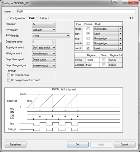

    The main.c contains only the 2 lines needed to 'start' the 2 Components - PWM and Clock, that are placed, wired, and configured on the project schematic ("TopDesign.cysch").
    That's all the CPU needs to do! The rest of the design runs entirely in hardware with no CPU intervention required.
    To see how the 2 Components are setup, simply double-click them to open the Component configuration window.

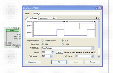

    Hi Chris, thanks for the information. I couldn't see from the main code nor the schematic, where the PWM depth is set. Has it defaulted to (say) 100% and requires a function call in main.c to change it?

    Hey Shabaz, you would double click on the PWM component (the green and grey PWM block shown in the schematic above) in Creator and it opens a configuration dialog called a customizer for you to set parameters like Period and Compare values.  Then you can change those values in code later with API calls like PWM_SetPeriod() and PWM_SetCompare() among many other things.
