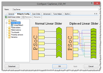

This is a very simple yet effective CapSenseRegistered demo that implements a 5-segment slider, like the one available on the Pioneer kit.

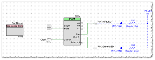

Project Schematic:
                            (Actual PSoC Creator project schematic "TopDesign.cysch")

  • 5-segment Slider - P1[1] - P1[5]

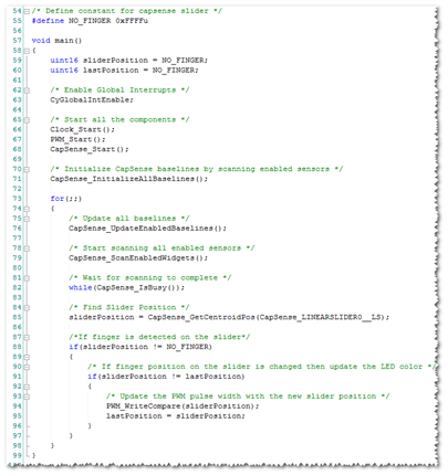

  • Main.C - This example project implement simple firmware in the project's main.c as shown below (already completed in the example project). The code implmented scans the CapSense slider, then updates the PWM's PulseWidth with the slider value.
                                      ( Project firmware - main.c )

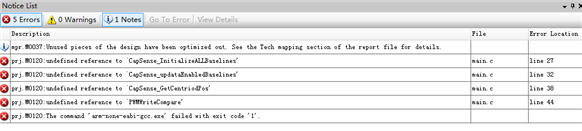

    Hi,
    Following the example,I write the code to build a CapSense project in PSOC Creat 2.2 SP1,but find there are some errors,such as undefined reference to "PWMWriteCompae";
    Could you tell me the possible cause of these errors and help me to solve it?
    Thank you very much.
    e14 Contributor over 13 years ago in reply to e14 Contributor
    Attach the .ZIP-file here and upload the project
    p4-capsense-1.cywrk.Archive02.zip
    Now I can build it succesfully.I need to write the right API function name,pay attention to the big or small letter.
    Thanks

    Thank you very much!
    Could you explain,in more detail,why the multicolor LEDs will gradually change color from red to green?
    After use PWM_WriteCompare() function to update the PWM pulse width with the new slider position,how does the waveform of the PWM's output(line&line_n changes)?
    Thanks
  • cy.gul
    cy.gul over 13 years ago in reply to e14 Contributor
    Hi Gui Zhao,
    By using the PWM_WriteCompare() API, you are effectively re-configuring the PWM Component's properties during run-time.
    By writing a new compare value each time with the slider position, the duty cycle of the PWM changes, which in-turn modifies the LED outputs.
    In our project, the PWM Component has 2 outputs, "line" and "line_n" - which are nothing but the inverse of each other (the sum total of these 2 outputs is thereby 100% duty cycle).
    "line" is connected to the Red LED while "line_n" (inverse) is connected to the Green LED.
    As you adjust the duty cycle of one of PWM outputs by writing a new compare value, the other one inversely changes. Thus, you are going from 0-100% duty cycle on one LED, and the opposite on the 2nd LED. The result to the naked eye is a gradual change between the LED output between Red and Green colors.

    This could be because you haven't assigned the CapSense slider to specific IO pins.
    You can do this by opening the "<project_name.CYDWR>" file from the project explorer.
    • Green LED - P0[2]
    • Red LED - P1[6]
