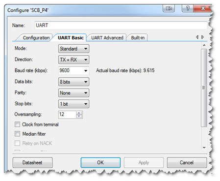

This project demonstrates UART communication over the kit USB-UART Bridge. The project uses the Serial Communication Block (SCB) based UART component which sends the string "CY8CKIT-042 USB-UART" and also loops back the data sent over the COM terminal software.

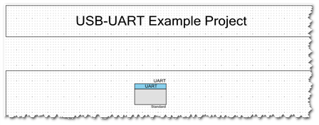

Project Schematic:
                           (Actual PSoC Creator   Schematic "TopDesign.cysch")
                                         (PSoC Creator   UART Component Configuration)

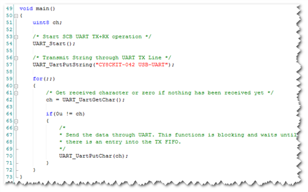

The main.c firmware in this project is very simple, it simply sends character data over the UART whenever the TX buffer is filled.
                                                      (PSoC Creator main.c firmware)

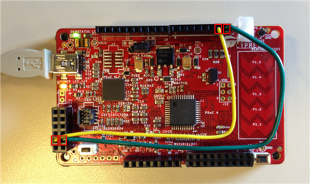

Hardware   Connections:
You will need to wire the UART TX and RX pins between the PSoC 4 and the PSoC 5LP on the pioneer kit (See picture below).
PSoC 4 UART RX P0[4] --> PSoC 5LP P12  [7] (on J8)
PSoC 4 UART TX P0[5] --> PSoC 5LP P12  [6] (on J8)

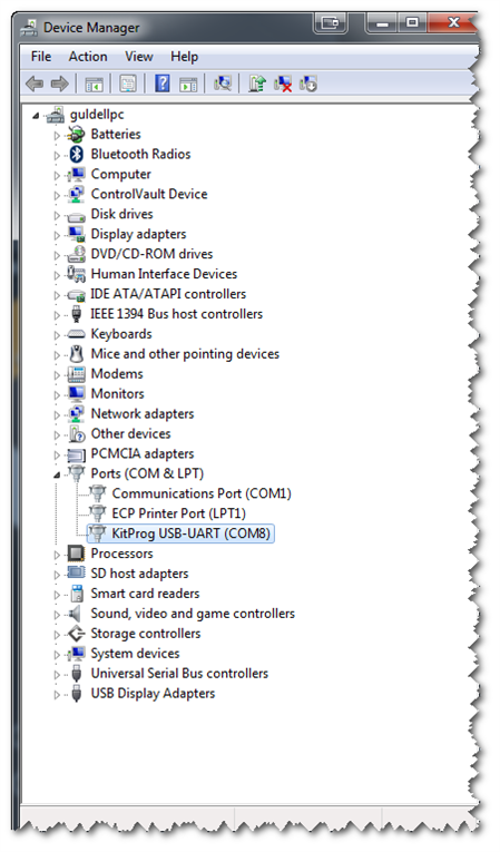

Once programmed with this project, your PSoC 4 Pioneer Kit is setup to send data over USB-UART. The board enumerates as a COM Interface, the number of which can be seen in Windows Device Manager. In my case, it enumerated as COM8. You will need this COM# to allow a program like Putty or HyperTerm to communicate with your board.
(The PSoC 4 Pioneer Kit enumerates as a COM device - COM8 in my case, your COM number may be   different)

    Thx for your project! But after I downloaded the program,the computer showed that it doesn't have USB_UART drive.Can you help me?
  • jesusantoniocar
    jesusantoniocar over 13 years ago in reply to e14 Contributor
    Hello  Rui Zhang.
    please uninstall the psoc 4 kit and install again. i have test this project,  it works. Check in device manager the port number that is using the pioneer kit(in my own case it is using com13) to make the configuration of your system terminal, i am using hyperterminal.

    e14 Contributor over 13 years ago in reply to jesusantoniocar
    Thank you very much.I changed my OS and solved the problem.

    Hi,
    As I am using a CY8CKIT-049-42xx Prototyping Kit, how can I map the p12[7] and p12[6] to my kit?
    Also, What are these two pins are doing when connected to rx and tx?
    Best
    Andrew
    dougw over 12 years ago in reply to e14 Contributor
