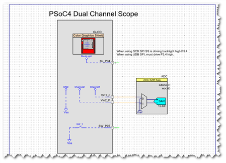

Hello folks!
Today we're posting another Oscilloscope project that uses the Color Graphics LCD Shield. This project is a little dual channel scope using the PSoC 4 Pioneer board and the SparkFun Arduino color graphics shield or equivalent.
The user input is via SW2 on the Pioneer board (none of the switches on the display are used). Tap the button to cycle through the options highlighted with a white box drawn around it. Hold the button for a second or more until the box moves to another parameter.
*      Trigger Channel:  "TRG 1" or "TRG 2"
*      Trigger Level:    From 100mV to 5000mV
*      Input Range:      5000mV, 2500mV, 1250mV, 625mV, 312mV
*      Samples per Second:  SPS  10k, 20k, 50k, 100k, 200k, 400k
Components used:
* Graphics LCD Component (over SPI)
* SAR ADC Component
* a few instances of the Pin Component

    Another fun project. I am curious about the way the two signals walked through each other. Is that due to the sampling or due to them being generated by different generators/time base? Keep up the fun…
  • mhastings
    mhastings over 13 years ago in reply to DAB +1
    DAB, I purposely made the two waveforms at a slightly different frequency so I could tell if I could sync to one or the other. The project lets you select the channel and the voltage level that you trigger…

    DAB,
    I purposely made the two waveforms at a slightly different frequency so I could tell if I could sync to one or the other.  The project lets you select the channel and the voltage level that you trigger on using the built-in compare function in the SAR SEQ hardware.  By the way, the waveforms are being generated by the PSoC5LP using two WaveDAC8s.

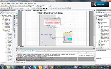

    thanks for this project, so i see the update about the lcd project, right now i see the next error.
    best regards,

    cy.gul over 13 years ago in reply to jesusantoniocar
    Hi Jesus,
    I've uploaded another version, that contains the dependant GraphicsLCD Component as well (its the same one we've been using in all the other GLCD examples).
    As a result, the .zip file is slightly bigger (~4mb).
    Please download and try this version, see if that fixes your problem - P4Scope2.zip

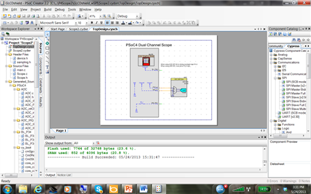

  • jesusantoniocar
    jesusantoniocar over 13 years ago in reply to cy.gul
    Hello Gagan.
    I debug the psoc creator project and compiled zero errors.
    thanks.
    Jesus Antonio.
