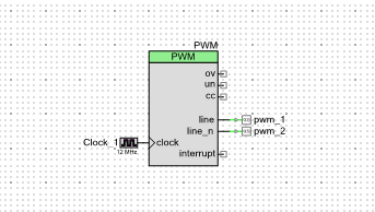

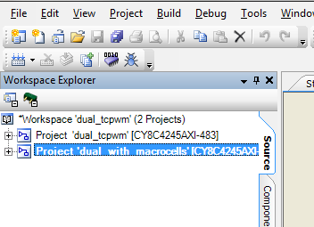

In the attached workspace contains two projects “Dual_TCPWM” and “Dual_with_macrocells”. Both of these examples address the challenge of creating two PWM outputs from a single PWM.

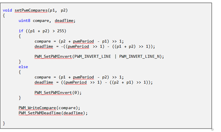

Dead Time-Based
The first, purely firmware-based method relies on using dead time together with the TCPWM’s compare value and clever manipulation of the PWM’s output inversion to effectively decouple the TCPWM’s two outputs.  Due to the reliance on dead time, this method is limited to periods of up to 255, as dead time is also limited to 255 counts.
The positive PWM output follows the below equation:
Where C is TCPWM compare, D is dead time, and T is PWM period.  The negative PWM output (PWM_n) follows the below equation:
Using these two equations, we can set up a system of equations that allows us to solve for the compare value and dead time for any configuration of PWM and PWM_n:
Reducing this matrix gives us the following for compare and dead time:
Unfortunately, though, this yields negative results for dead time when the two PWM densities sum to more than 1.  To solve this problem, both outputs are negated, and the two input densities are switched before compare and dead time are calculated.  The code below demonstrates how this technique would be used to configure a TCPWM PWM:

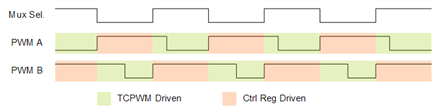

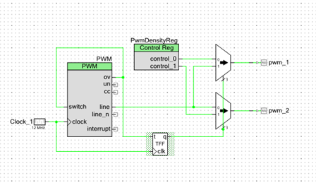

PLD-Based
The PLD-based method relies on external logic and compare-swapping inside the TCPWM.  This method allows 16-bit resolution, but uses 5 p-terms, 3 macrocells, and 2 control register bits.

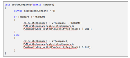

This method uses the TCPWM’s OV output to trigger its own switch input, switching between its two compare registers.  In this way, the output of the TCPWM is only driving one of the outputs at a given time, while the other is being driven by a control register.
The control register is written with a 0 or 1 depending on the amplitude of the desired compare.  The T flip flop automatically switches the mux so that the outputs are kept in sync. The code for configuring this TCPWM follows:
