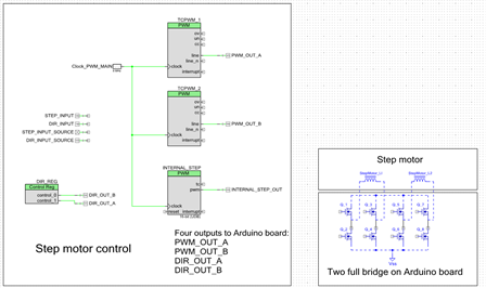

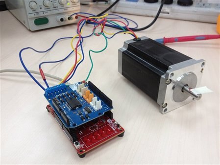

In today’s example we will be showcasing a very simple stepper motor example project. In this example we show you how to spin a stepper motor using the PSoC 4 Pioneer kit and the Arduino Motor Shield.

Components Used:
The user can download the example project at the bottom of this post. The project uses the following list of Creator Components:
  • PWM
  • Control Register
  • CyClock
  • CyPin
The components are configured by right clicking on the component in your Top Design schematic view and selecting Configure. Please enable the following selections in the Configuration windows for the listed components above.

Hardware Connections:
Connect the Arduino Motor Shield to the PSoC 4 Pioneer Board. Then connect wires from the stepper motor to the Arduino Motor Shield and power the motor.
Test Your Project:
Program your project and power up the Motor Shield using an external power supply.

    I'm going through Project #045 Stepper Motor Controller and am correlating project code, PSoC 4 schematic, and ArduinoMotorShield Schematic and I noticed that Dir_Out_A doesn't go to the correct pin in the project.
    The project states PSoC 4 chip pin P3[4] which goes to J3.3, but on the Arduino, this is not connected to anything. The pin for DirA on the Adruino should try to PSoC 4 chip pin P3[1] going to J3.5.
    Also, Dir_Input on J2.16 physically doesn't connect to anything.
    The code I'm using is from the "First 50 Projects" zip and not from this blog page. I'm not sure if they are different.
    Does any of this sound right?
    Thanks,
    Jim
  • greatunclebulgaria
    greatunclebulgaria over 12 years ago in reply to marsmen
    Jim,
    Having a quick look at the "Project Images.zip", at the bottom of the first post, - the "Pin Selection.png" picture shows that DIR_OUT_A does go to P3[1].
    I would suggest you look at the files in this posting, and see if they tie up with your hardware. Looks like the other setup from the "First 50 Projects" has the wrong revision of "code".
    Hope you find the correct source for your project.
    David

    marsmen over 12 years ago in reply to greatunclebulgaria
    David,
    Good call, the project zip photos didn't match the corrects pins. I updated just that one and the thing runs way smoother, but still not like what is shown. I'm guessing that there is some other stuff that is different as well.
    I would say, "First 50 Projects" definitely does not have the same code. Next would be to load from this posting and give it another go.
