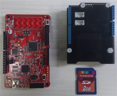

Today we are starting a short series targeting SD memory cards. In this first example we are introducing users to the SD card using the custom SD card component. This component will expose simple API level commands to read from and write to the SD card. In this example we are targeting a 2gig SD memory card.
  • PSoC 4 Pioneer Kit
  • SD Card shield
  • 2 gig SD card

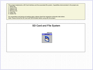

Components Used:
The user can download the example project at the bottom of this post. The project uses the following list of Creator Components:
  • SD Card
  • CyClock
  • CyPins
The components are configured by right clicking on the component in your Top Design schematic view and selecting Configure. Please enable the following selections in the Configuration windows for the listed components above.

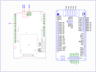

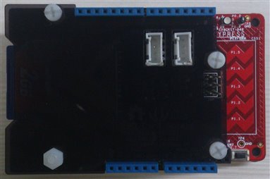

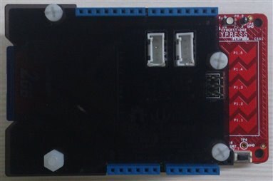

Hardware Connections:
The SD card shield uses the 6 pin header for SPI communications. This header on the Pioneer board is, by default, not populated. You will need to solder on a 6 pin header to enable this connection. The Seeedstudio SD card reader uses the 6 pin header to communicate over SPI to the SD card. Once you have added this header connect the Seeedstudio shield to the Pioneer kit.
Test Your Project:
Program the example into the PSoC 4 kit. Edit and play around with the commented code to create new files. Then remove the SD card and plug into an SD card reader or PC that has an SD card port to verify the PSoC 4 actions.

  • jesusantoniocar
    jesusantoniocar over 13 years ago
    Hello Matt.
    Thanks for this project.
    Please could locate in the post an additional photo of  the sd shield on the opposite side, I would see the connection or the type of header that I soldered to the board, (pioneer kit) to make the connection with the sd arduino shield.
    thanks.

    For the benefit of others, the revised PSoC4 pin assigments are:
    SDCard:SPIM:sclk_m      P0[6]
    SDCard:SPIM:miso_m     P3[1]
    SDCard:SPIM:mosi_m     P3[0]
    SDCard:SD_CS               P3[4]
