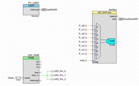

Components Used:
The user can download the example project at the bottom of this post. The project uses the following list of Creator Components:
  • UART
  • Sar Sequencer
  • ISR
  • PWM
  • CyPins
  • CyClock
The components are configured by right clicking on the component in your Top Design schematic view and selecting Configure. Please enable the following selections in the Configuration windows for the listed components above.

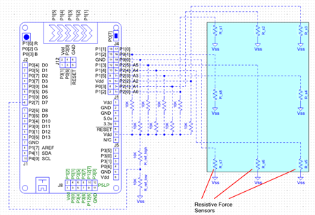

Force measurement can be very simple or very difficult depending on the constraints of your system. Were this an example for a cell phone, the sensors would need to be very small, screen printable, and cheap. Suitable technology for low cost sensors exists, but we chose to use a similar but more convenient force sensor.

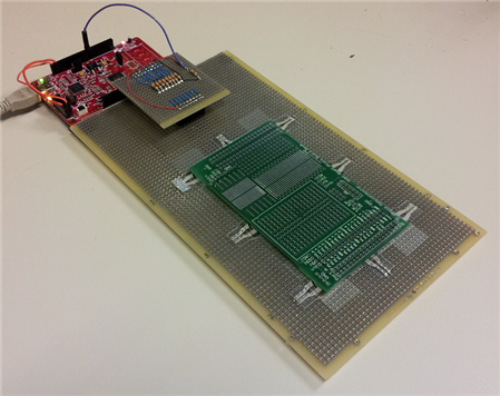

Eight Flexiforce A301 sensors are placed underneath the ‘glass’, such that they support the weight.  This ensures that no force escapes, and that the calculation made with this data will be accurate.  A large source of error in these sorts of calculations is unplanned translational forces getting into the measurements, augmenting the location and force of the touch.
These force sensors, being essentially variable resistors, are measured with a half-bridge configuration.  This configuration removes common mode noise, which is a significant portion of the noise in the measured signals. 10 kOhm resistors are used, as they were about the resistance of the sensor under the target loading.  The middle of each bridge connection is connected to pins on the PSoC4 for measurement, through the Pioneer Kit’s J2 connector.  The PSoC4 simply measures these signals with a sequencing SAR, with the bridge reference tied to the SAR’s reference input.

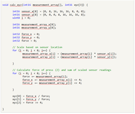

Calculation of the touch location is done using the SAR sequencer measurements and the known sensor locations.  The following equations define the location of a single force applied to the screen. Yp is the vertical location of the touch, and Xp is the horizontal location of the touch.
These equations are implemented in C, relying primarily on multiply-accumulates, and one divide.  PSoC4’s CM0 core handles these calculations easily.  The code for calculating touch location is shown below.

Hardware Connections:
The following schematic view capture provides the user the layout and values for the system. Please connect the breadboard or touch system to your PSoC 4 Pioneer kit.
Also connect the PSoC 4 UART connections to the PSoC 5LP device so the UART positioning can be relayed up to the host.
PSoC 4 P4[1] -> P5LP P12[6]
PSoC 4 P4[0] -> P5LP P12[7]
Test Your Project:
Program the Pioneer kit and then touch the resistive touch panel you’ve created. Run the python script on your PC to read and display the values from the Pioneer kit. Please see an example of the system in action below.
