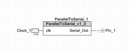

Today’s example is the release of a community component for a parallel to serial UDB component. At the bottom of this post we have included the example project for the component and the custom component datasheet. The key point of this component is that it’s applicable to PSoC 3/4/5LP device families.

The user can download the example project at the bottom of this post. The project uses the following list of Creator Components:
  • Parallel to Serial
The components are configured by right clicking on the component in your Top Design schematic view and selecting Configure. Please enable the following selections in the Configuration windows for the listed components above.
Firmware Description:
The main.c firmware is included in the example project. Please review the commented sections for more details.
The parallel to serial component contains a set of datapaths that allow conversion of any parallel data, given to the component, to be transmitted in a serial data output. The required baud rate can be set using the clock input.
In this example we are outputing some parallel values to the serial port. Feel free to test out this example using and Oscope to verify the serial output content.

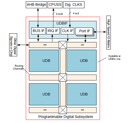

    This project uses one Datapath instance for implementing Parallel to Serial conversion. Every UDB block contains one Datapath instance. So, you can use 4 such instances of this component in a 42xx family…

    How many instances does the Psoc 4 support?
    e14 Contributor over 13 years ago in reply to DAB
    This project uses one Datapath instance for implementing Parallel to Serial conversion. Every UDB block contains one Datapath instance. So, you can use 4 such instances of this component in a 42xx family of PSoC 4 which contains 4 UDB blocks. It is not possible to use this component in 41xx family as they don't have any UDBs.

    Thanks for your explanation. i have to say too that  the UDB array also provides a switched Digital System Interconnect (DSI) fabric that allows signals from peripherals and ports to be routed to and through the UDBs for communication and control.

    That's what I thought, but I wanted to make sure so that everyone could see how these programmable hardware blocks work.

    Oh - it may also be interesting to state that PSoC 4 also has 2 SCBs (serial communication blocks) that can do SPI. Effectively, these are additional 'Parallel to serial' blocks that 41xx as well as 42xx parts have.
    PSoC 4's UDBs (Universal Digital Blocks) are a pretty versatile Programmable Logic fabric, in that there are a number of small custom functions that you can perform with them.
