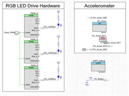

Components Used:
The user can download the example project at the bottom of this post. The project uses the following list of Creator Components:
  • PWM
  • UART
  • I2C
  • CyClock
  • CyPin
The components are configured by right clicking on the component in your Top Design schematic view and selecting Configure. Please enable the following selections in the Configuration windows for the listed components above.

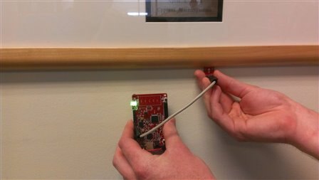

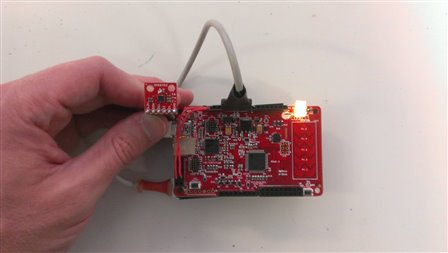

For this example plug the Sparkfun three axis accelerometer breakout board into the J3 header, pins 1-6. You may need to solder wires or a header to the accelerometer. In our example we connected the accelerometer to a six pin cable. This allowed us to move the accelerometer around while holding the pioneer kit in our other hand. Please be careful of the orientation of the ribbon cable, if you reverse the polarity on the accelerometer you may cause damage to the device.
Test Your Project:
Connect your hardware and program the kit. Take the accelerometer and set it on a flat surface. Notice the LED begin to change color and then glow a bright green when on a level surface.
