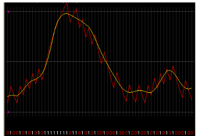

Encoding the Data:

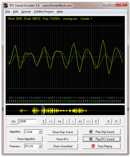

The sound effect .wav file was converted to 1-bit format byte array using the free BTc Sound Encoder 3.0 software developed by Roman Black.
There are some important features to this software:
  • Being able to resample the data at a different rate
  • Simulating what the 1-bit sound would sound like
  • Seeing how the 1-bit sound wave matches the actual sound wave
  • Exporting the 1-bit format data to a ‘PIC Mikro C file’.

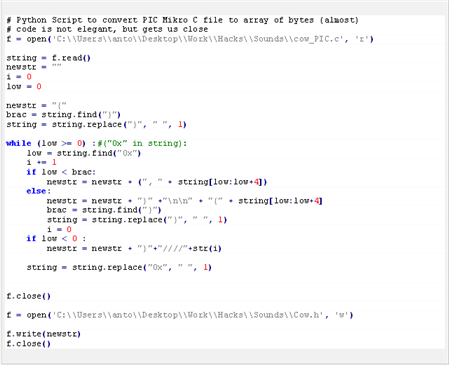

Formatting the Data:
The generated code from the above application is not directly readable by the PSoC. It needs to be converted to an array of bytes to allow for the array to be initialized when declared. This step was done using a Python script (attached to this post).

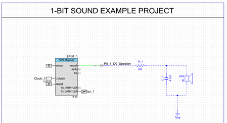

Once the sound is ready to be initialized as an array in C, playing it out with the PSoC is simple. In the example we use the SPI component to output the values to the RC circuit. The array of data is shifted out MSB first using the SPIM Component.
  • Since the data was sampled at 11.025 kHz, the SPIM is clocked at 22.050 kHz to achieve a bit-rate of 11.025 kHz.
  • Playing around with the (external) passives did not have much of an effect on playback quality. Playback quality is primarily determined by the bit-rate and is a tradeoff with the flash footprint.
  • The flash footprint of the projectwith 5 sound effects (bark, bell, boing, quack, crowing) is ~9k.

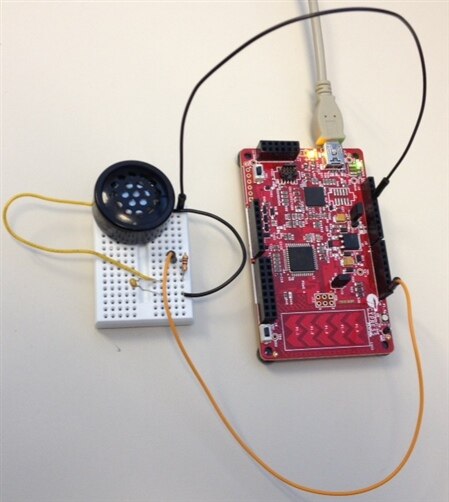

Hardware Connections:
In this example the user will need to connect an external RC circuit to an external speaker. The SPIM component is then connected to Pin 0[4].
Test Your Project:
Program the Pioneer board and enjoy the sound effects.

    4. To get better results, buffer the pin output using PSoC 4's opamp, before sending it to the speaker. You will notice that the resultant waveform at the speaker (seen on an oscilloscope) is much more like the screenshots above.
    5. The sound quality is in a large way determined by the bitrate and size of the audio samples.

    Well I download the project and got it working with the default sounds.  I tried running BTc.exe to create a different bit scream.  The problem is I am running window 7 and the download site is saying XP or maybe vista.  I cannot open a wav file. Has anyone tried to run this in Window 7 or even 8.1?  I tried several different wav files.  I get the following Msg:
