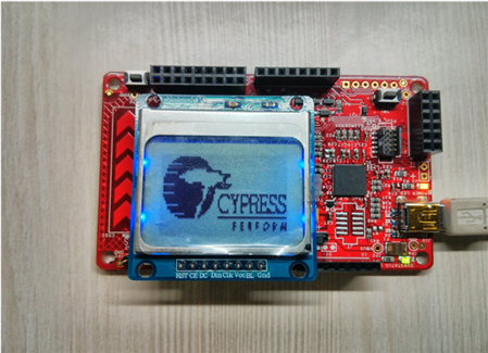

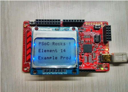

Hello!
Today’s example we are showcasing how to interface to the Nokia 5110 LCD screen with the PSoC 4 Pioneer Kit. This simple display provides a 84 x 48 Graphics LCD that was used in the Nokia 5110 model in 1998. This example provides a simple example to write text and an image on the LCD screen. This example uses a bit-banging method for sending the data & clock from the CPU to the LCD panel. The project does not require any UDB resources, therefore it can be used with the PSoC 4 (42xx and 41xx families).

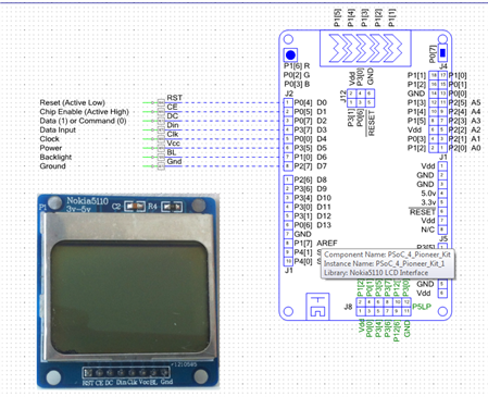

In this example, LCD initialization is done as specified in the datasheet of PCD8544 LCD driver which is used in the LCD panel. It is not necessary to use all 8 pins of PSoC 4 for interfacing this LCD. Reset, Chip Enable, Power, Backlight & Ground pins can be connected to fixed voltage levels on the board. Only Data/Command, Data & Clock pins are used for sending the data to LCD.
Hardware Connections:
In this example we are not using any specific headers or shields. Instead we are providing a firmware example to interface with the Nokia 5110 screen. We have connected the screen in the following connections:

Connect your screen and program the Pioneer kit. See the screen display the example text and images.
I hope this example can help you in your design.

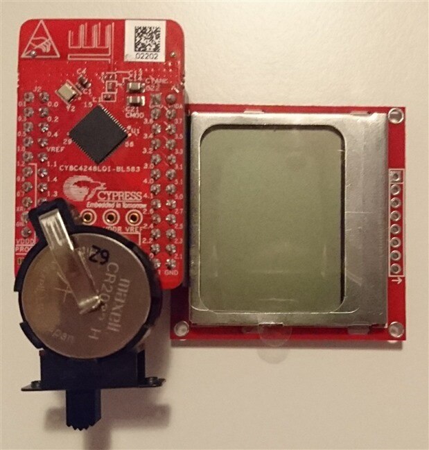

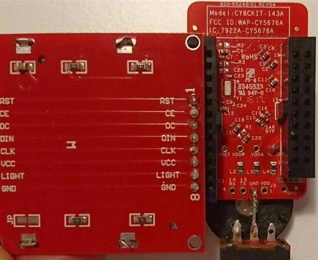

    chr1sg75 over 6 years ago
    I know this is an old post, but hopefully someone is still listening :-)
    I have tried to get this to work on the Cypress PSoC 4 Bluetooth BLE module (CY8CKIT-143A) but am having no luck.
    Obviously, I have changed the device in the project to the correct one, but apart from that, should I worry about anything else?
    I used the following pins (and updated the project to reflect these changes)
    RST -> P3.7
    CE -> P3.5
    DC -> P3.3
    DIN -> P3.1
    CLK -> P5.1
    VCC -> P5.0
    GND -> P2.5
    (I didn't connect the BL pin because I don't need the backlight)
    Any suggestions why I'm getting nothing on screen?

  • chr1sg75
    chr1sg75 over 6 years ago in reply to koudelad
    Hi David,
    Thanks for taking the time to reply. Glad to see the forum is still alive.
    I have dug out an old BitScope, so I am in the process of debugging the signal lines.
    For what it's worth, I can answer some of your suggestions:
    - The backlight illuminates when the LCD is powered (although BL needs to be pulled low).
    - It's the first time I've used the LCD, so I haven't seen anything on the screen previously. I guess it could be dead.
    - The PSoC definitely runs
    - I will post my archive if I fail to diagnose with the 'scope
    And of course, if I figure out what is going wrong, I'll post an update.
    Cheers
  • chr1sg75
    chr1sg75 over 6 years ago in reply to chr1sg75
    Update:
    I have 'scoped the signal lines and things appear to behaving as I would expect.
    I did wonder why the CE line is not set high during initialisation, but I guess if it doesn't matter as long as the LCD is reset properly.
    I will upload the archive and perhaps someone can tell me what I might be doing wrong. Also, some photos to show the hardware setup.
    p.s. I added a Temp signal so that I could have a known line to trigger the 'scope.
