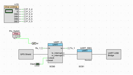

The user can download the example project at the bottom of this post. The project uses the following list of Creator Components:
  • Char LCD
  • UART (x2)
  • CyPins
  • ISR
  • CyClock

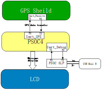

The firmware for this PSoC 4 example pulls in GPS data from the target GPS module and displays the parsed location on an LCD module. The PSoC 4 receives the GPS data via UART from the GPS module. The data packets received from the GPS module will be then displayed on an LCD screen.

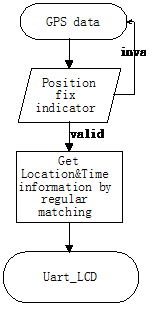

The following image is an example of the firmware flow. The firmware checks to see if a valid position fix is obtained. If a valid fix is found then the data is then parsed and displayed on the LCD module.

For this example the user will need to connect GPS module to the UART component outputs.
Next connect an LCD module using a bread board and wires. This section is not necessary since you can use the second UART in the example to send data using the USB-UART bridge on the Pioneer board and see that data using a hyperterminal application.

    Hello Matthew,
    I think,
    In .cydwr file Rx_1 pin is connected to P3[1] (uart_tx) which actually should be P3[0] (uart_rx).
    Otherway round should be for Tx_1 pin.
    Regards,
    Sarang
