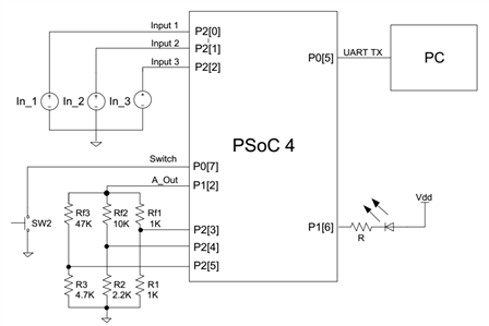

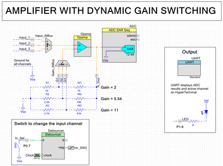

In today’s example project we are continuing to explore more analog centric projects. In this example we are implementing a 3 channel amplifier with a dynamic gain switch. Based on your end design you may want to change the gain of your amplifier when reading in your analog signals. In this example we use a button selection to control the gain on the amplifier, but in your design you may change the gain by inputs from your system. The values are then sent over the UART port to be displayed on a Hyperterminal application.

The Opamp is used to amplify the input signal. Selection of input channel is done using Input_Amux and selection of the Gain is done using the Gain_Amux. The UART is used to send ADC results through the UART bridge on the PSoC 5LP.
The Debouncer component is used to remove glitches from the input switch. The SAR ADC converts the analog output of the OpAmp into digital values. The ADC also generates an interrupt when its input is outside the defined voltage window (250mV-750mV). The LED is turned on when the ADC generates this interrupt.

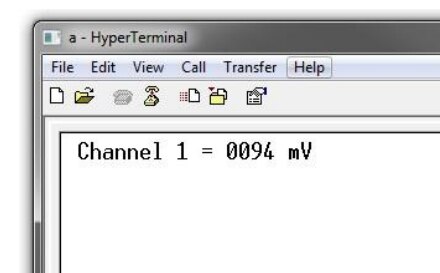

The data displayed over the UART includes the ADC output of the active channel along with the channel number to the HyperTerminal.

The external hardware connections for this example are detailed in the schematic capture for this project. We include the external components and layout information using the annotated components. These annotated components detail the various resistor values needed to control the variable gain amplifier.

Program the Pioneer board and connect your three input signals. Then connect the UART to the PSoC 5LP and launch the hyperterminal software to view the UART output.

  • koudelad
    koudelad over 9 years ago in reply to eduardosilva
    Values of what?
    If you mean the input voltage, all is limited by the ADC and the gain of the op-amp. The ADC for PSoC 4200 family (see the datasheet, section Analog Blocks) has an operating range of 1,71 V to 5,5 V (which should correspond with the voltage powering the PSoC). The gain of the op-amp is according to the schematics above set by the resistors to three possible levels, 2, 5,54 and 11. Divide the operating voltage of the ADC by the selected gain and you get an upper bound of the input. The lower bound is the same as Vcc of the microcontroller (in this case), which is 0 V.

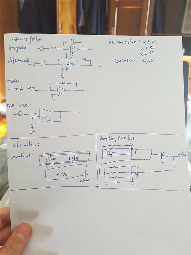

    Look I'm a student, and i have a final project to do for the university.
    Here, we never work with PSOC, so i dont know very much about this. So, i'm trying to do some examples to learn.
    In my project I have 4 analogic filters ( integrador, diferenciador, inversor, no inversor ), and i need to multiplexing the resistors to do a remote lab, with labview help!
    So, in this moment I'm kind desperated, so any angel can help me with this project? (I pay if it's necessary) image

  • eduardosilva
    eduardosilva over 9 years ago in reply to michaelkellett
    Hello friends.
    I leave here some items that I need for this final project.
    I need to multiplex the various filters.
    I do not know how to control the multiplexers, since I'm supposed to receive some characters from the client that will define which filter to use.
    Along with Psoc I will also use an elvis ni, and the labview.
    Any angel that can help me with this part of Psoc at least?
    I'm a bit desperate, please some help.
    Thanks for listening!
    Best regards, dear friends

  • michaelkellett
    michaelkellett over 9 years ago in reply to eduardosilva
    You'll need a Psoc user to help with Psoc specific stuff, do you have to use a Psoc or can you use any micro and some external hardware ?.
    Looks to me as if you need a dual 4 way analogue multiplexer - lots around - no problem. You component choice is bad - good quality 10uF capacitors are very big and very expensive, for filters you should use film capacitors or COG/NPO type ceramics. High value ceramic capacitors are very voltage dependent so introduce distortion.
    If you made the capacitors 1uF 63V film types you could scale the resistors up by a factor of 10 and have the same filter frequencies, but with sensible size of capacitors.
    BTW, that integrator looks worrying - there is no DC feedback on the amplifier so it will sit with its output at one rail or the other - perhaps you haven't shown us the complete circuit.
    Let me know if you have to use Psoc and if not I'll try to sketch out how to use the multiplexers. Do you have a design spec for the whole thing, and what is it for ?
    MK
