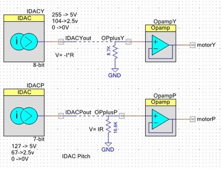

to convert a current source to a voltage source I used a voltage follower OPAMP that would not consume current so if that current was redirected through a Resistance then this Resistance would generate the requiered voltage for my signal
When routing the OPAMPS make sure to pick the right pins (this ones are dedicated) you can find them on the Pioneer Kit Guide (apendixes.- Pin layout)
The commands requiered on the firmware are this ones:
->Initialization
IDACP_Start();
IDACP_SetValue(motP);//67
OpampP_Start();
///IDAC YAW
IDACY_Start();
IDACY_SetValue(motY);//118
OpampY_Start();
Command (Change value)

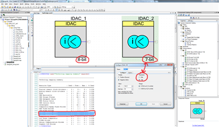

    Hi Juan, Very interesting project you have in the making. Would love to see how you progress with this! For the IDACs - There are 2 CapSense IDACs on the PSoC 4, but only one of them is 8-bit. The 2nd…

    There are 2 CapSense IDACs on the PSoC 4, but only one of them is 8-bit. The 2nd IDAC is a 7-bit resolution. Using the Component Configuration Tool you can select the resolution setting, and then use both IDACs in a single design. See my screenshot below.
