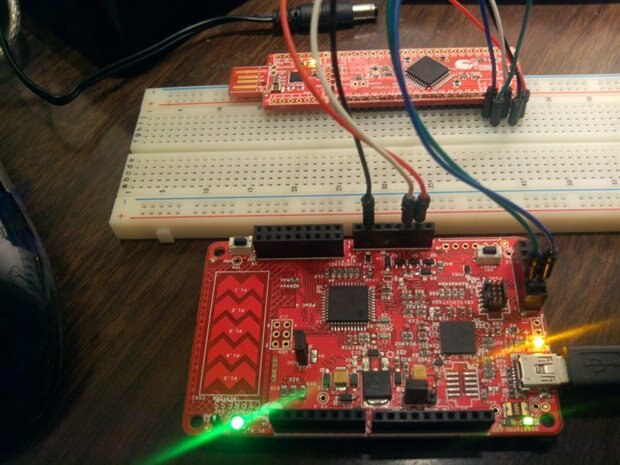

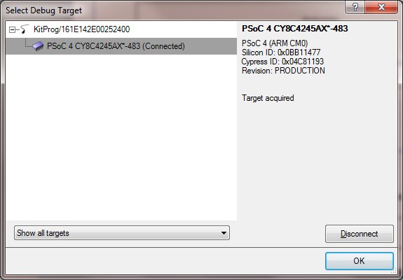

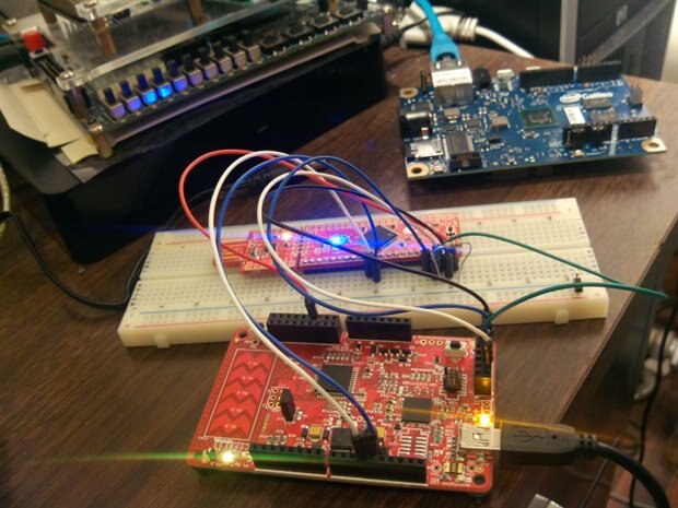

    e14 Contributor over 12 years ago in reply to e14 Contributor
    Success:
    I connected the Pioneer's PSoC 4 P3_0, P3_1, GND, P4_VDD & /XRES to the same pins in the prototype kit.
    For SWDIO and SWDCLK used the PSoC 5LP P0_0 and P0_1 and connected those to the prototype board.
    I only had to change the ProgKit pinout for SWDIO from P5LP2_0 to P5LP0_0  and SWDCLK from P5LP2_1 to P5LP0_1 and wired it as shown here:

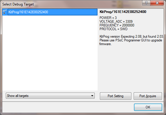

    Now I can use program directly from Creator 3.0 and if I open Debug/Select Debug Target... I get the KitProg with the chip enumerated within it.

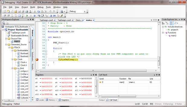

    Finally I was able to attach to the running program or debug it from scratch and set a Breakpoint
    Thank you for making the KitProg source available! image
    Edit: I was too hasty about debugging from scratch, but I can however attach to the running project and put breakpoints after attaching, will investigate further about being able to use F5 to debug from scratch. Also P3_0 and P3_1 don't seem to be needed, and the pull-up resistor probably can go away as well.

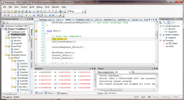

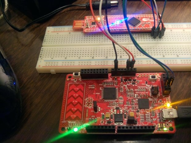

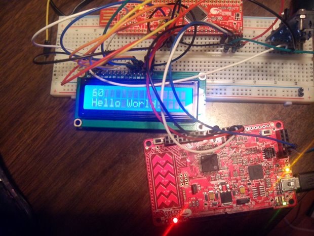

    If the program is not bootloadable it has full debug, meaning you can press F5 and step through the code from main.
    Of course I don't run it in such a small window, I resized the IDE to make it more post friendly image
    Excuse the mess of jumper wires, but this has the Pioneer debugging the prototype kit that runs a frequency counter (on the floating yellow wire on the left) that is picking up the 60Hz mains that is everywhere.
    The frequency counter code comes from this site:
    self.clue++ : Starting the PSoC frequency counter series
    I overdid the contrast so it will show up in the camera. Also the thing on the right of the breadboard is two pots and a buzzer, i'm using one of the pots to adjust the contrast of the LCD screen. Although it could be controlled with and analog output pin and use capsense to adjust it.
    So it's acting like a MiniProg3 after all. Also I didn't need the pull up resistor nor the 2 wires for SPI, so it's a 5 wire programmer just like the MiniProg3.

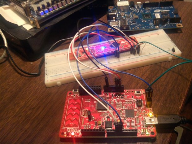

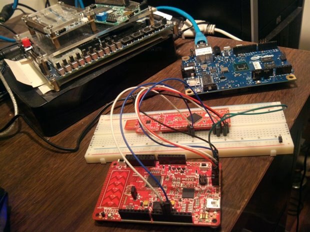

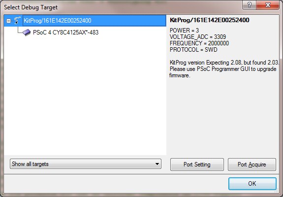

    So that there is no doubt, other than the 4200 $4 prototype kit I have a 4100 $4 prototype kit as well.
    I soldered one set of male headers like I did on the previous one and hooked it up to the breadboard and fired it up.
    The 4100 chip showed up under the KitProg:

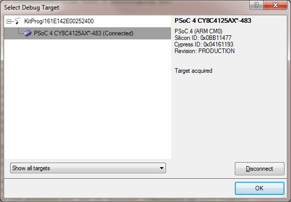

    Also I was able to acquire it:
    And program it with a bootloadable image, and of course you can program and debug it the same as the Pioneer built in 4200. Note the capsense pionner RGB demo is still running in the built in 4200 I just did touch the slider to turn it green instead of red. The 4100 has the blinky bootloadable demo but I could use it to display something on the LCD, but no analog so I didn't bother.
    If you want more detailed connections or explanations (I would think it's clear enough if you look at the schematics), let me know in this thread. a thumbs up will help too even if the hard work was really done by the hard working folks from Cypress. I just rewired 2 pins!
    I don't have access to PSoC 3 boards or PSoC 5LP ones either, nor the original PSoC 1. So I don't know if they will enumerate right, I don't see why not but I didn't look deep in the code. I do however have 40 4200 chips for a small project in all three packages (QFN, TQFP & SSOP) that I intend to use the Pioneer to program them.
    Edit: this should work for the 4000 chips as well.
