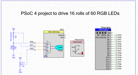

The user can download the example project at the bottom of this post. The project uses the following list of Creator Components:
  • ADC
  • ThermCalc
  • StripLights (custom component)

Today’s project focuses on using the StripLights custom component. This component drives the popular WD2811/12 RGB LEDs. The component will support from 1 to 16 strings of LEDs. In the component we have support for a 24-bit RGB color lookup table and the ability to display 5x7 character font. Also supported are Pixel, line, rectangle, and circle primitives. The component supports both the 400 and 800 kHz LED controllers. The StripLights component will consume between 2 and 4 UDBs depending on the channel count selected by the user. The StripLights example supports the following APIs for application development:

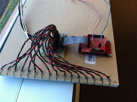

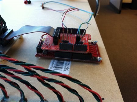

Hardware Connections:
In the images below you will see our hardware configuration for this billboard. In the design powered our system using a PC power supply. We connected the 5V supply and ground line to a breadboard. From that breadboard we powered each of the 16 LED strips. From the breadboard we connected the 16 data lines from the PSoC 4 and the power and ground connections. In this example the PC power supply is powering the LEDs and the Pioneer board. Also connected to this example was a Thermistor and a resistor. This allowed us to display the ambient temperature on the display. The Thermistor layout is detailed in the schematic design.

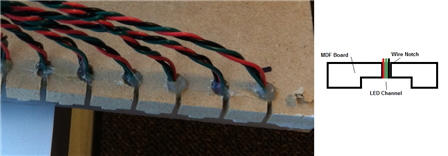

The LED display was built using MDF particle board. We used a wood router to machine 16 channels 1 meter long. The LED strips were then placed in the channels. At the end of the channel a notch was cut to allow the wires to easily exit the back of the display. Clear caulking was added to hold the wires in place. The protoboard and the Pioneer board were connected to the MDF board using wood screws. A thin plastic diffuser was connected to the top of the MDF board using wood screws. We used a plastic diffuser to diffuse the LED light. The LEDs can tend to be direct and very bright. The diffuser allowed for a clean and continuous display.
