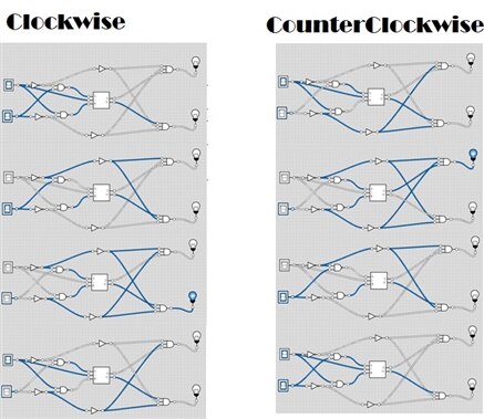

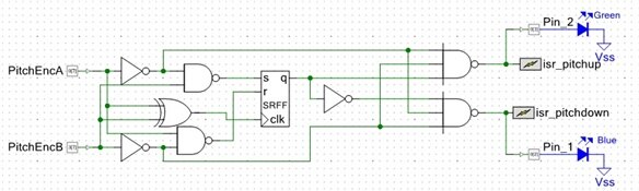

I need to read two rotary quadrature encoders at the time I didnt know that the PSOC4 could work with the TCPWM Quadrature decoder but I really enjoyed this circuit It is a really good example of the digital logic power included on PSOC.
the great thing about this is that all the circuit logic is made via hardware that means there is no work required by the processor until it reaches the causes the interrupt. this way I won't waste processing power on this reading.
here is a little simulation of how this works notice that on each case only one of the lights turns that would turn on the interrupt sequence for that pin.

    You can further offload the decoding by adding an up-down counter component. Just use a single ISR to inform the processor of a change of value. As DAB says - "Just a thought."

    Juan, nice work! This is an excellent example of how you can use the simple digital logic Components in PSoC Creator to make your own peripherals or functions, entirely in hardware! In addition to the…

    Thanks for this very useful circuit, I am just about pushing the boundaries of a PSoC 5 chip with my own hardware design and I could not accommodate the PSoC 5 Quadrature Component in the build.
    The only thing I lose is the counter, but that can be a software counter running from the interrupts.
    I had component space to add a De-bounce component to both inputs, which takes away the warnings regarding the signals not being synchronous and should reduce the possibility of switch bounce corrupting the count.
