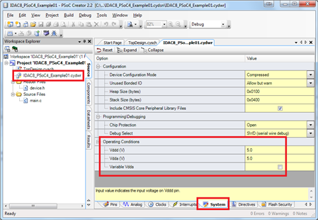

the designer wont let me configure 4 channels of 5v ref ADC.  it states the max 3.3v.
When I asked at the meeting about this it was mentioned it supported it.  So I suspect I am missing something specific to the pioneer board.
  • cy.gul
    cy.gul over 13 years ago +1 verified
    Hi Michael, This is probably happening because your system supply is set to 3.3v. You can change you system to 5.5 and then the ADC option will allow a higher VRef as well. To do this: 1. double-click…
  • cy.gul
    0 cy.gul over 13 years ago
    Hi Michael,
    To do this:
    1. double-click your design's .cydwr file to open the system configuration
    2. In the 'system' tab change your operating voltage to 5v

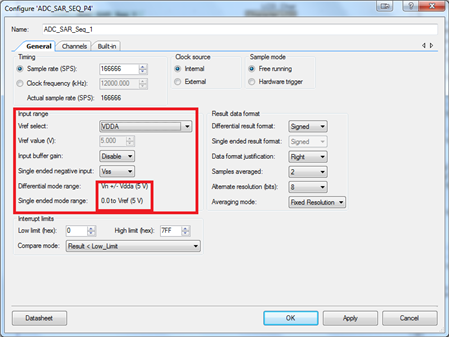

    3. Back in the SAR ADC config, you can now select the 5v reference

    Thanks!  That was the answer.  Now if I could figure out how to mark the conversation as "answered"?
