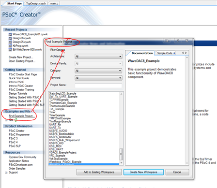

    great input by COMPACT, you can use the IDAC on PSoC 4 to generate waveforms (V = IR, so you'll need external resistors).
    I'm attaching an example of the WAVDAC Component on PSoC 5LP, its a pretty straighforward component that has some initial setup and literally no firwmare to run it.
    Btw, you can find this example project and others in the "Find Example Project" window in PSoC Creator.
    WaveDAC8_Example01.cywrk.Archive01.zip
