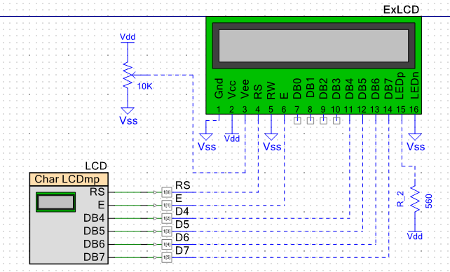

I have tried the Cypress LCD component as well as a Community component where you can select different pins.
In both the cases I get some junk on display ? I did manage to get the custom component working for a while but now that's also not working.
I have been through the LCD component's datasheet like a 1000 times and almost tried all the functions but with no luck ?? Please help !!

    check this out this project has a lcd block with 4 data wires interface instead of 8 for a 2x16 character LCD
    http://www.cypress.com/?app=forum&id=2492&rID=75707

    0 gsgill112 over 11 years ago in reply to juanes.pazj
    Yes my wiring is correct the above Image is a custom Component which I found on psoc developer fourm.  and out of ~20 tries I have made the LCD worked once or twice using the above component. I have also double checked the LCD with Arduino's LiquidCrystal Lib and the Lcd works just fine.
    I have no luck with the Cypress LCD component. I guess I have to write my own component.

    0 dougw over 11 years ago in reply to gsgill112
    A common problem with these displays is when the host MCU is reset, it may not reset the LCD and the LCD ends up in a state that the MCU is not expecting. Be sure the LCD is being properly reset and its mode is entirely under control. Find a sequence of instructions that is guaranteed to put the LCD in a known state and execute whenever there is doubt. There are several of these sure-fire sequences published on the net - usually for arduino applications.
  • gsgill112
    0 gsgill112 over 11 years ago in reply to dougw
    @Douglas Wong, I guess the LCD_Start() takes care of resetting the LCD, at-least with the MultiPin component ! I don't know how to view and modify the code for the Stock Component ?
    You don't need to modify the code if you can send commands (as opposed to data).
    Just find a command sequence that ensures the display ends up in a known state, regardless of where it started.

    0 clem57 over 11 years ago
    I think you need to see the low level approach to ensure correct operations. I would checkout this:
    http://www.scribd.com/doc/17686517/JHD162A-LCD-Code
    Especially the Init code with correct delay...
    Your problem is that the display keeps its state during MCU reset. When cold-booting, the initial data mode is 8-bit which you immediately switch to 4-bit which reads data with a pair of EN pulses.
    When you reset the MCU, you do not know whether even or odd number of EN pulses were sent. So you have to somhow reset the display even if it does not have reset pin.
    This can be done by sending 0x33 0x33 (in 8-bit mode it will mean 4-times switch to 8-bit, in 4-bit mode it will mean once or twice switch to 8-bit). Then you can be sure that you always start from the same state.
    Then proceed with regular 0x32 (or 4-bit 0x02 if you have single 4-bit write function), 0x28 to get into 4-bit 2-line mode.

  • gsgill112
    0 gsgill112 over 11 years ago in reply to clem57
    @Clem Martins     The LCD is not the problem, previously I was working with the CharLCd() component in PSoC creator and it pretty much looks like a black box, So I don't know of a way to see the backend code.For the new component I am working I have to incorporate the 0x33 0x33 hack !!Although , I also tried shutting down the power to reset the entire System, as when the LCD boots It doesn't remember the previous stage but that didn't help !!
