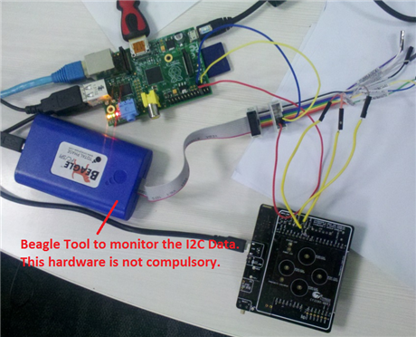

Hardware Connections:
The following list of steps will help you configure your hardware to ensure proper functionality.
  1. Connect the MBR3 I2C Lines from pin-2 of J13 and J14 jumpers to corresponding I2C lines of Ras pi available on P1 header.
  2. Connect the MBBR3 GND to Ras Pi GND on available on P1 header
  3. Power the MBR3 kit separately using the Mini USB cable
  4. Note: Don’t power the Kit from the 5V connection available on P1 header of the Ras Pi.
  5. Keep the Jumper J11, J12 shunted.
  6. Keep J15 jumper in “C” configuration i.e. Enable Buzzer and Water Tolerance enabled.
  7. If you want to enable different features just generate the 128 byte of configuration data using Ez-Click and replace the data of configData = [ ] array.

Test Your Project:
After enabling the Raspberry PI system please take a moment to review the Raspberry Pi I2C Python step steps linked below. These steps will help you enable the I2C drivers on the Pi.
http://www.instructables.com/id/Raspberry-Pi-I2C-Python/#step1
Download the example python code from this post and run the code using the IDLE which is installed as part of the Raspbian image.
