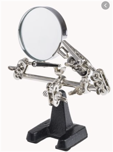

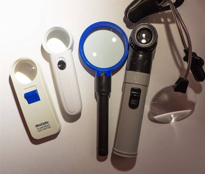

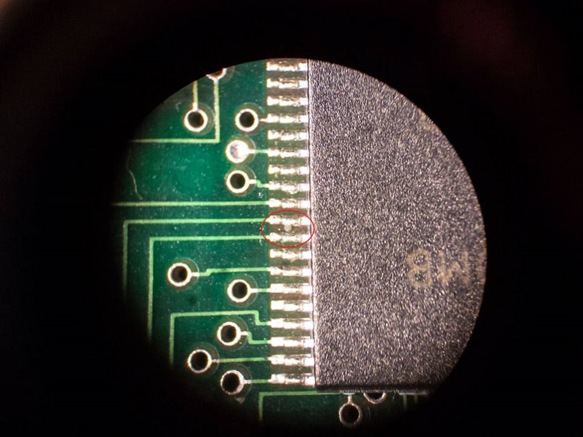

Handheld Magnifiers
I often make do with a small handheld magnifier with a built-in lamp and it works ok for the larger SMD devices. I have tried many different types of handheld magnifiers in the past.
Usually the magnification is quite low, so one is forced to use it close-up to the eyes in order to get a bit more magnification. Possibly this is not healthy! My favorite is the one on the left in the photo (incidentally amongst the cheapest, under $10). It has an LED on the underside and it is angled just right to be very useful. The batteries last a very long time – I’ve not had to change them for a couple of years.

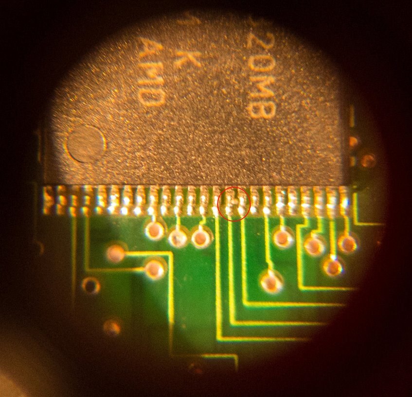

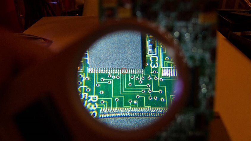

Here is an example PCB with what looks like a fault, as seen through this magnifier. I’ve tried to take the photograph to reflect what I see through the magnifier with the naked eye. So, I’ve positioned the camera very close (about 5cm away) from the magnifier, and it has been manually focussed to a relatively short distance which is what I would do to try and get more magnification out of it. The red circle shows the fault – something like a blob of solder bridging two pins of a 0.5mm pitch integrated circuit. It can be clearly seen, although with a bit of eye strain. I think this is a good magnifier, provided your eyesight is not bad.
Looking at the next magnifier from the left, the photo below is the view through the super-cheap e-bay special (just a few $). It has two LEDs on the underside, but they have poor color rendering as you can see from the photo, which makes it quite hard to get a clear view of things. I would suggest that this is second-worst magnifier in the lineup (the worst is yet to come).
The photo below shows the view from a SAAME magnifierSAAME magnifier - the middle magnifier in the lineup photo.
It is a physically larger diameter magnifier, and the result while clear, shows that the magnifier is not intended for detailed PCB inspection. Also, there is an incandescent bulb fitted in the handle (the type of bulb that was popular in flashlights – it has a glass molded lens as part of the bulb), but it doesn’t illuminate the correct area very well. The photo below shows the PCB being illuminated from the rear, just to get a clearer view.

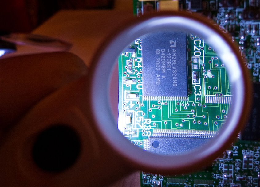

Another approach is to use an inspection loupe type of magnifier, which is designed for close-up work. One from Mitutoyo was used for the photograph below. It comes in two parts – the Mitutoyo handle with an incandescent bulbMitutoyo handle with an incandescent bulb and the Mitutoyo magnifier portionMitutoyo magnifier portion .
In use it has to be placed almost against the PCB, and then your eye can be anything from around 10cm to right up against the loupe, and the target will remain at a good level of magnification. The solder blob is clearly visible. Also, notice how the PCB on the right of the photo is blurred, yet on the left side of the photo all the stuff on the table is still in focus. This is because the Mitutoyo loupe is less straining on the eyes. Plus the level of magnification is the highest out of all the ones tested. It is a really great choice.
The solder blob is clearly visible with the Mitutoyo loupe as can be seen in this close-up photo:
Finally, the worst magnifier was one from a local store; it was intended for use as a clip-on book lamp; it was on sale and so I thought it was worth a try. However nothing was too clear through it! and I learnt that a book magnifier is almost useless for electronics work.

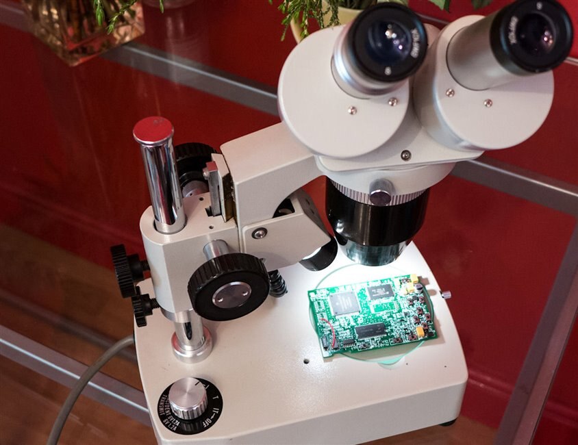

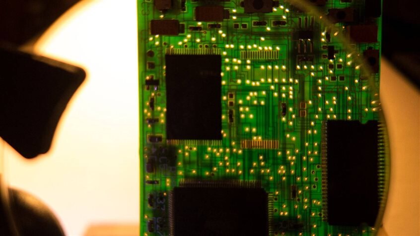

A binocular microscope is another option. This one was a very old model Meiji EMT that I got for next to nothing and cleaned up:
If you are buying a microscope for PCB inspection, you’ll need to check that you can get a good distance between the object to be observed and the lens assembly – otherwise larger components like electrolytic capacitors may get in the way when trying to read the markings on a small surface mount integrated circuit. This Meiji microscope allows for about 8cm working distance. It also has a built-in lamp with angle adjust capability so that the subject under test can be illuminated from the best direction for maximum contrast. The image is excellent and it is very easy to observe detail, this is the view looking down the eyepiece (10x magnification eyepiece, 2x magnification objective):
The Meiji EMT has a 4x objective setting too if even greater magnification is needed. Microscopes can be connected to a camera with an appropriate adapter. If a digital single lens reflex (DSLR) camera is available then the lens mount is standards-based so there is a strong possibility that an adapter could be purchased. Otherwise it is sometimes possible to build your own adapter.

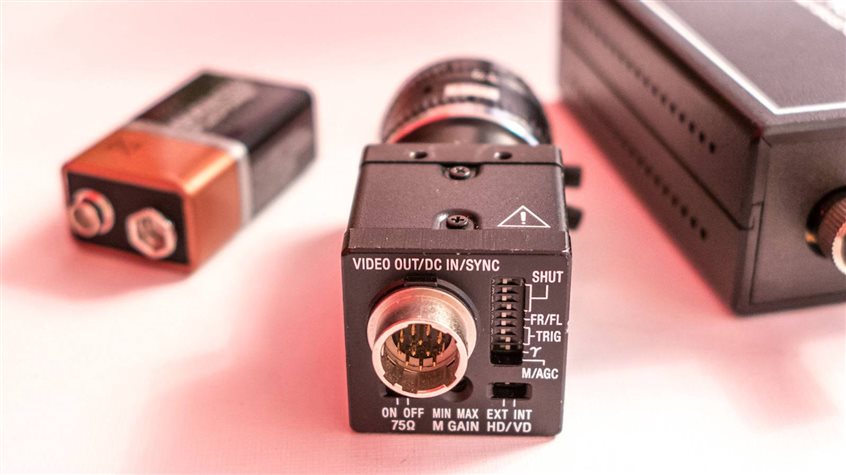

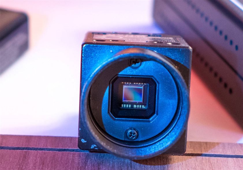

I didn’t want to dedicate a DSLR for PCB inspection so I decided to use an industrial camera (used for things like machine vision, e.g. inspection of items on a conveyer belt in a factory). They are compact cube-shaped things, around the size of pool cue chalk. Often the lens is bigger than the camera.
This is the view of the sensor (not recommended to leave it open like this, in case dust gets inside!):

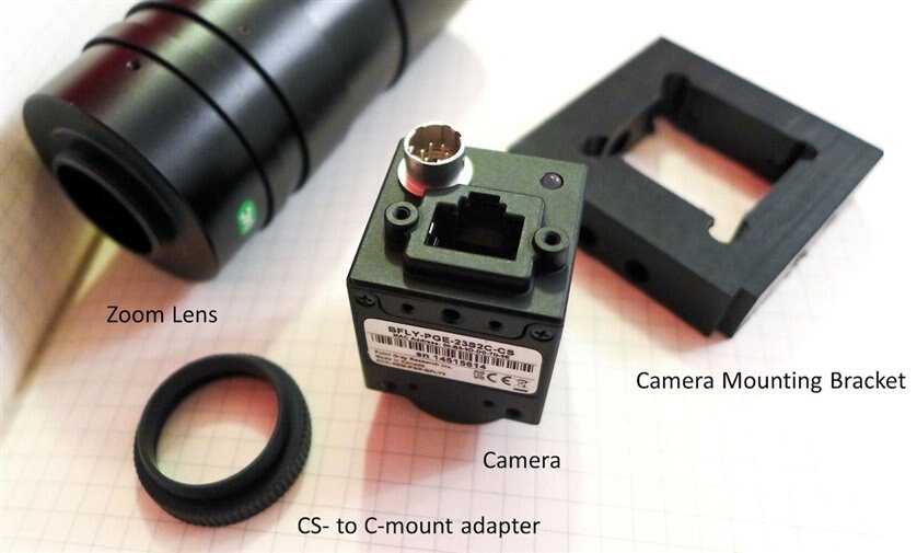

These cameras come with C-mount or CS-mount fittings which are standards that define the screw thead and diameter and the distance from the mount to the sensor so that lenses can be interchanged between cameras. It was easy to find an off-the-shelf adapter to connect between the C-mount camera and the microscope from ebay. The particular camera in the photo above is standard definition (and used and monochrome – I don’t think it would be worth spending money on a color standard definition camera nowadays – see below for HD cameras) and has an analog (composite) output that can be directly connected to a monitor so that I don’t have to use a PC for it. Otherwise it is possible to connect to a PC for recording images or video by using a video capture card.

For the lens I went with a recommendation on a forum and selected a Computar zoom lens model MLH-10X. The zoom capability is extremely useful. Fixed focal length alternatives include Fujinon (Fujifilm) lenses – they have very nice fixed focal length lenses intended for machine vision. An adapter to go from CS- to C-mount is also needed, because the Point Grey camera has a CS-mount and many machine vision lenses have a C-mount.
My reason to go for a zoom lens is that it is highly desirable to go from a zoomed-out view on a PCB and then quickly drill-down to a smaller area by adjusting the zoom. Also, with machine vision lenses it is possible to quickly lock the aperture and focus settings with a thumbscrew, and a benefit of this was found to be that you can adjust the zoom by feeling for the lens and only one ring will turn (the zoom ring) without taking your eyes off the PCB.

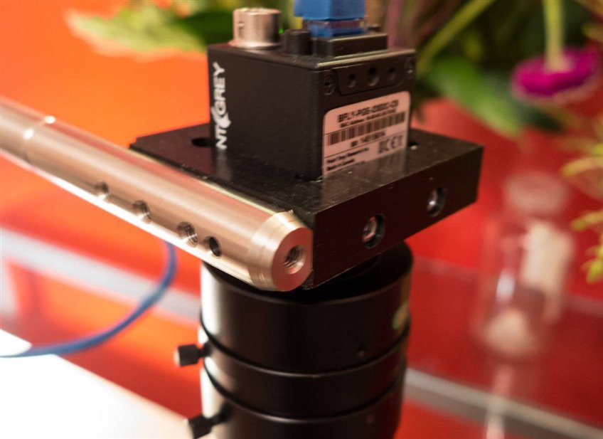

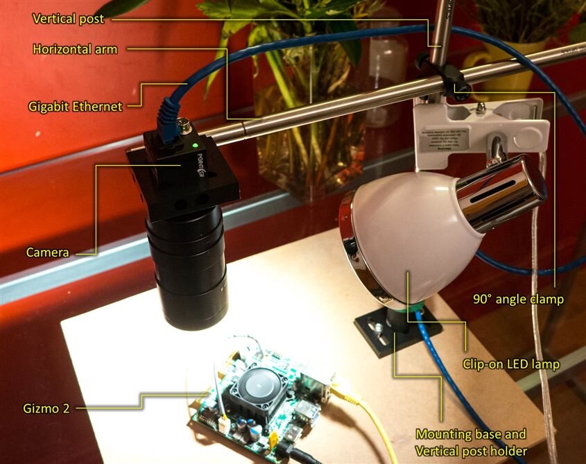

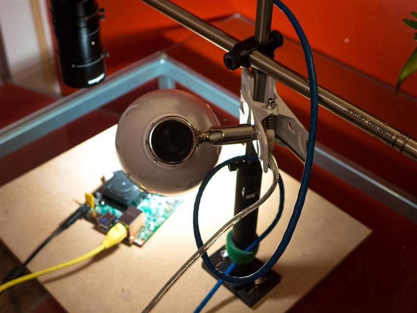

Building a Camera Stand
Some type of stand is required; with a zoomed-in picture the camera would be unusable without one. The camera has M2 and M3 screw holes so a piece of plastic was drilled appropriately (or a 3D printer could be used). The photo below shows the bits and pieces used to construct the camera head.
The camera stand assembly is shown below (the camera is inspecting its own Gizmo 2! – the blue and yellow cables go to a switch – see text further below). The assembly was mainly constructed from 0.5” diameter steel posts from Edmund Optics. Best practice is to use 1” or thicker for such designs, but 0.5” is much cheaper and worked fine. It is extremely stable, and can be rapidly swung out of the way if not needed.
The angle clamp and mounting base was from Thorlabs. Not shown but important, there is a small thumbscrew-tightened collar underneath the angle clamp. It is needed to ensure the camera does not slam into the table accidentally whenever the clamp is adjusted.
Another view is shown below. The lamp (mains operated) was fitted with an LED lamp for a cool workspace. The Ethernet cable was held in place with Velcro. The assembly is just bolted to a piece of wood for now –it could be screwed directly onto a wooden table.
The camera is connected to the horizontal arm as shown below, using a flattened post from Thorlabs

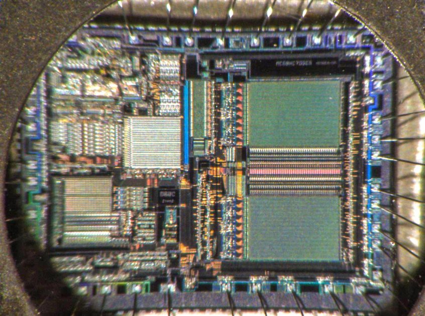

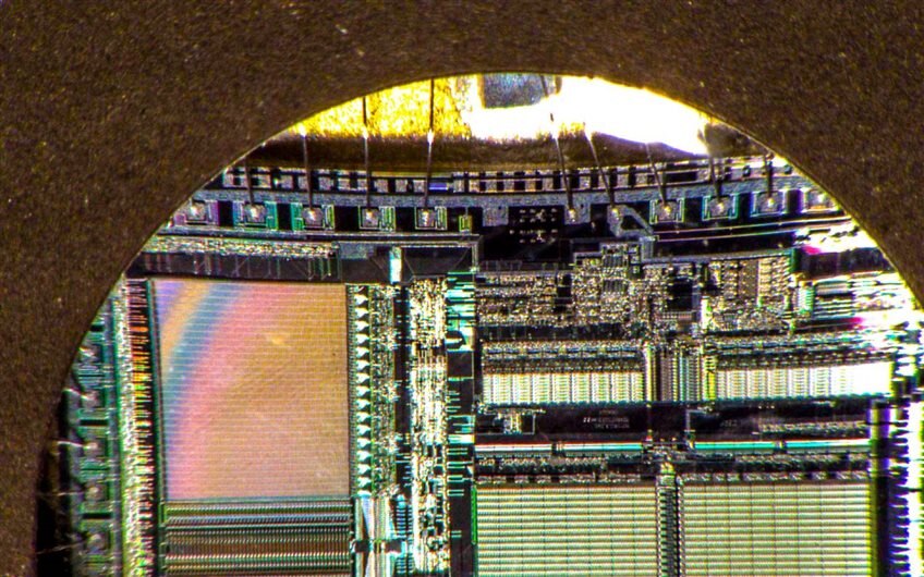

Although not intended for integrated circuit die examination, this is the view looking inside a Motorola 68HC11 microcontroller (a point-and-shoot camera with macro capability would provide a better static photo, but this photo is from a video stream of course:
The image would be better with the die bare, but it is still clear that the lens is sharp enough for good detail.
Here is a 68HC705 device:

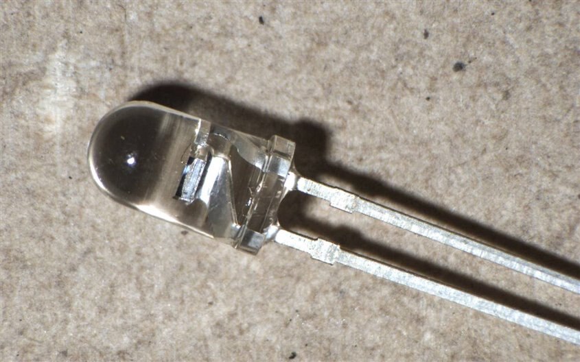

Some more photos just for fun. This is looking inside a 5mm red LED:

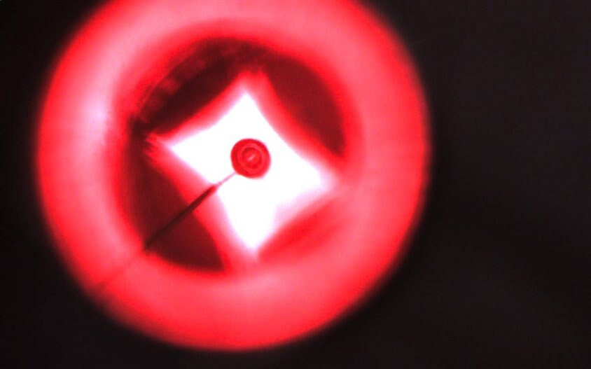

A BPV10 photodiode:

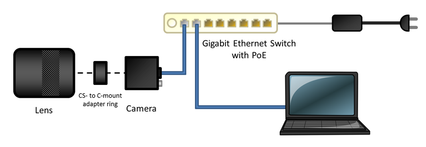

Using a Gigabit Ethernet Switch
The next step was to integrate the camera into the home network. A Gigabit Ethernet switch is needed with jumbo frame capability (not all support this, so definitely check! Also, don’t assume that the capability is enabled on the switch by default – usually it needs to be configured).
Jumbo frames are packets of data (payload and header, also known as an Ethernet Frame) with a larger size than that defined in the Ethernet standard. Throughput can be increased by using jumbo frames because less header content is transferred on average compared to the payload volume.
Power over Ethernet (PoE) capability is a nice-to-have feature because then just a single cable needs to connect to the camera and you get the benefits of energy efficiency and remote management and control. There are several PoE standards in existence. If you’re purchasing a new switch then ensure it has PoE+ capability at a minimum (also known as IEEE 802.3at-2009) and then the switch will be useful for powering many types of modern devices.
The PC network adapter in Windows was configured to enable jumbo frames up to 9014 bytes (to do this, navigate to the network adapter’s Network Connection Properties dialog and then select the Jumbo Packet property and set to 9014 bytes in the drop-down selection). Note that if you also use your PC to connect to other networks then you may need to disable this setting after you’ve finished using it with the camera.

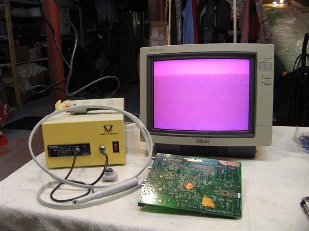

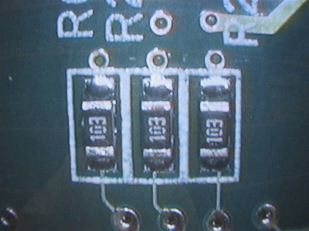

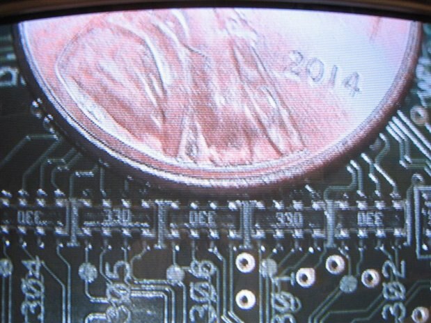

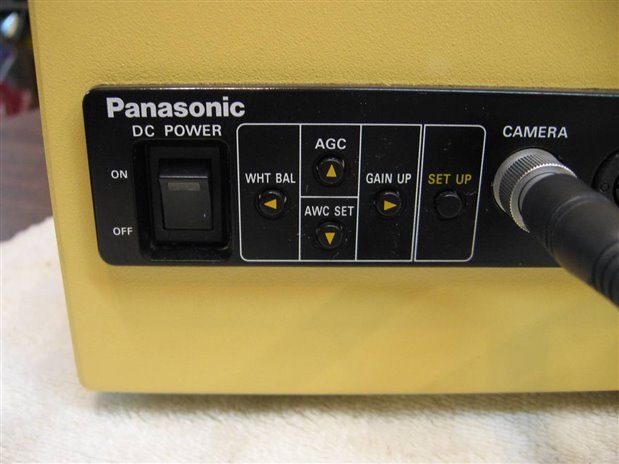

    Your mention of a dental camera reminded me that I had one on the shelf that I had saved from my business. The camera system is an Oralvision and it sold to the dentist for $6,000  back in1993. For the fun of it I got it out and fired it up. It has a camera with 2 attachments. One is a straight on lens that is able to be focused down to about 5 cm. The other attachment is an angle handpiece that allows one to get about a 1 cm away from the object of interest. Both camera attachments are supported by an integral fiber optic light that ties back to a quartz light in the camera power supply. The monitor is a Sony with some neat features like a switch that allows the operator to mirror image the capture. The only output from the camera case is an amphenol plug to an S-Video.  The monitor has many in and out jacks which are all presently obsolete. I will experiment further with this camera by getting an S-Video to USB adapter and then tie it into my computer and monitor. Here are some pictures of the system and what it does.
    I took this shot with the a regular digital camera as I wanted to highlight the size of the resistor arrays under the penny.
    The straight on camera attachment has a poor depth of field. Another quality problem I have here is that I am having to photograph the Sony Monitor's screen with my digital camera. I am holding the dental camera with one hand and my regular camera with the other. I also have the f-stop on the light turned up too bright in this picture.
    Here are the same resistor arrays with the angle attachment.
    Here are (3) 603 size resistors blown up so that they measure 20mm by 40 mm on the monitor screen. The angle attachment was about 1 cm from the board in this picture.
    This is the control panel on the camera power supply and light box. I am a poor engineer as I haven't cracked the case yet to look inside.
    I mention this old dental camera as this vintage is no longer desirable by the dental profession so they are sitting around in basements and backrooms. I bought this one for $25.00. Perhaps there are more of them out there if anyone is looking for something that was high quality and is inexpensive now. Check with a dentist or a dental supply company in your area. I will let you know if adapting it to the computer allows me to improve the image.
