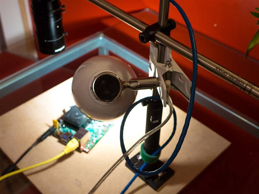

Building a Camera Stand
Some type of stand is required; with a zoomed-in picture the camera would be unusable without one. The camera has M2 and M3 screw holes so a piece of plastic was drilled appropriately (or a 3D printer could be used). The photo below shows the bits and pieces used to construct the camera head.
The camera stand assembly is shown below (the camera is inspecting its own Gizmo 2! – the blue and yellow cables go to a switch – see text further below). The assembly was mainly constructed from 0.5” diameter steel posts from Edmund Optics. Best practice is to use 1” or thicker for such designs, but 0.5” is much cheaper and worked fine. It is extremely stable, and can be rapidly swung out of the way if not needed.
The angle clamp and mounting base was from Thorlabs. Not shown but important, there is a small thumbscrew-tightened collar underneath the angle clamp. It is needed to ensure the camera does not slam into the table accidentally whenever the clamp is adjusted.
Another view is shown below. The lamp (mains operated) was fitted with an LED lamp for a cool workspace. The Ethernet cable was held in place with Velcro. The assembly is just bolted to a piece of wood for now –it could be screwed directly onto a wooden table.
The camera is connected to the horizontal arm as shown below, using a flattened post from Thorlabs

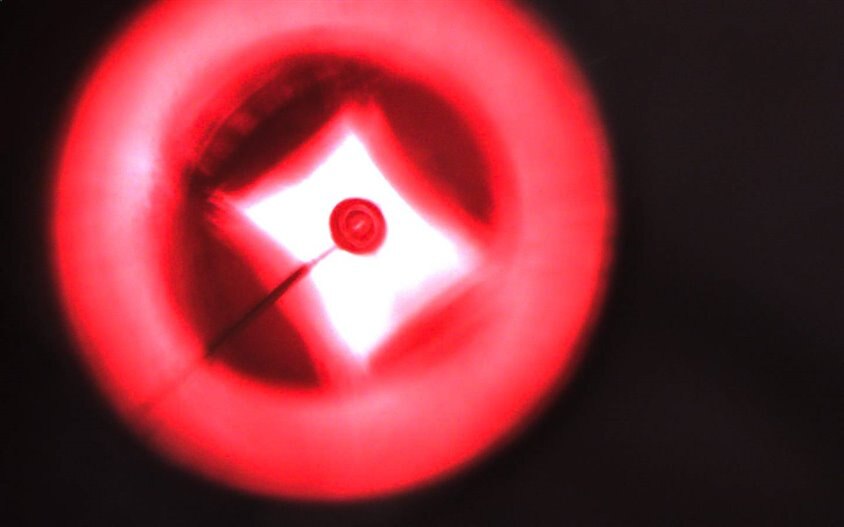

Some more photos just for fun. This is looking inside a 5mm red LED:
