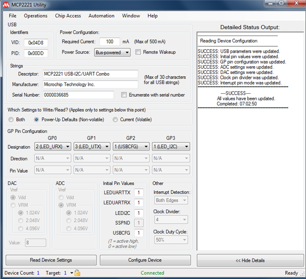

The MCP2221 is actually quite flexible; it is possible to wire up LEDs for status information or have general purpose input/output (GPIO) connections or even control I2C devices. This wasn’t explored – I was only interested in the USB Serial adapter functionality. There is a Windows based utility that can be used to configure the MCP2221, it looks like this:
