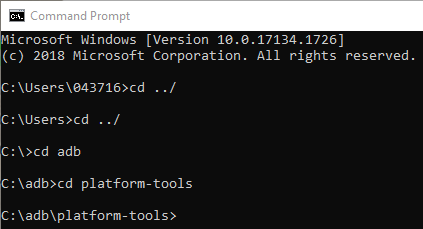

    1. Open up command line prompt
    2. Traverse in the command line prompt to the adb tools you setup. Go to the platform-tools directory
      • image

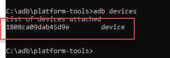

    3. In the command line type adb devices
      • It will show your device ID
      • image

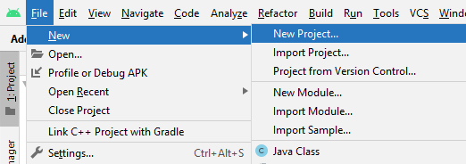

    1. Create a new project File -> New -> New Project

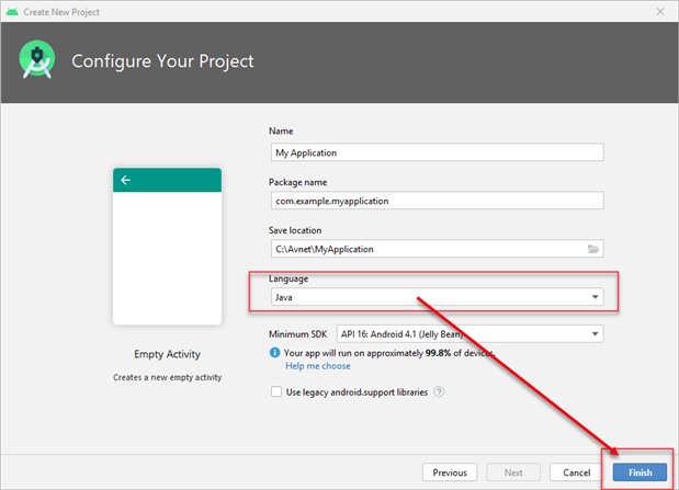

    2. Select Empty Application -> Next
      • image
    3. Make sure the Lanugage is set to Jave and select Finish
      • image

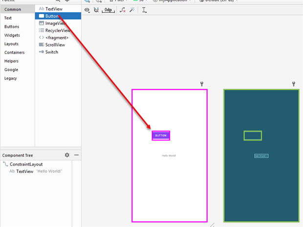

    5. Go to Android -> app -> res -> layout -> activity_main.xml
      • image
    6. This is where you design the layout of your app. You can drag and drop multiple buttons/tesxt/widgets etc into your application
      • image
    7. If you go to the Code portion you will see the .xml code that was created when you dropped your button. You will notice here is where we can rename the button id that our java application will call when a event occurs.

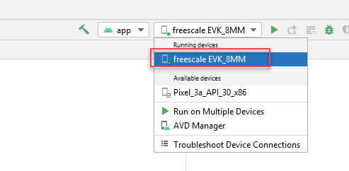

    1. Make sure in Android Studio the target selected is freescale EVK_8MM
      • image
      • If you don't see freescale EVK_8MM make sure your MaaXBoard Mini is powered up and you can communicate with it using the adb tools.

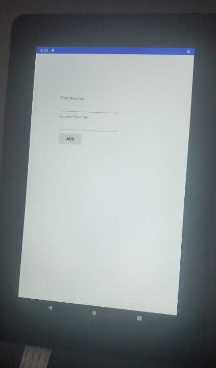

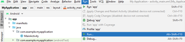

    2. In the Android Studio menu select Run -> Run...
      • image
    3. You will see this output on your MaaXBoard Mini
      • Play and explore the application, try and compare it to the code we just added into our application to see how it works
      • image

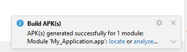

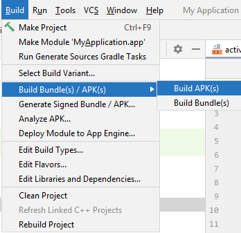

    2. In the Android Studio go Build -> Build Bundle(s) / APK(s) -> Build APK(s)
      • image
    3. In the bottom right you will see when the APK has been build, select locate to open the directory
      • image
    4. You will see the APK has a default name, rename it to whatever you wish.
