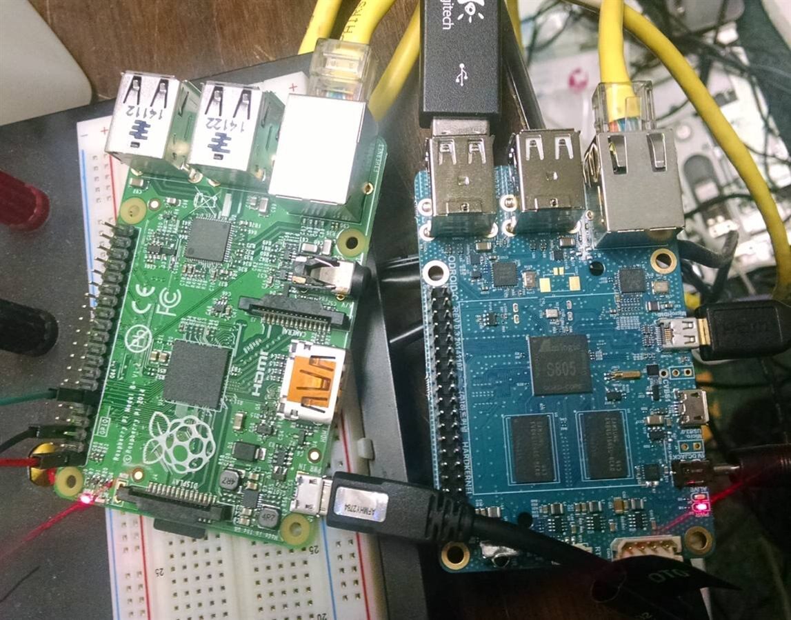

I recently picked up one of these little ODROID C1 development boards and i have to say I couldn't be happier!
It's a Quad Core ARM dev board based on the Amlogic S805 Cortex A5 processor with a Dual Core Mali 450 GPU. It comes with 1 GB of RAM and can can boot from 2 sources eMMC and Micro SD. $36.95 US.
It's layout looks very similar to the Raspberry Pi+, and it is almost the same size. Here is a picture of the 2 side by side:

A quick look at the pinout for both  the ODROID C1 and the Raspberry Pi shows they seem to match up with the exception of pins 37,38, and 40 on the ODroid are used for ADC.
It's also missing a few things the B+ has built in, like the camera interface, composite video out, discrete audio outputs, and the Display header.
