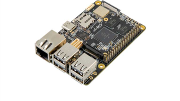

In the benchmarking results, we have seen that MaaXBoard Mini is a powerful board, with results comparable to Jetson Nano when benchmarked on the Mobilenet model:
Despite it's name, the MaaXBoard Mini is mighty indeed! It boasts Quad Cortex-A53 at 1.8GHz and Cortex-M4F at 400MHz, a speedup compared to regular MaaXBoard's Quad Cortex-A53 at 1.5GHz and Cortex-M4F at 266MHz.
At only $72.50, it's one of the most cost effective boards capable of running Machine Learning.

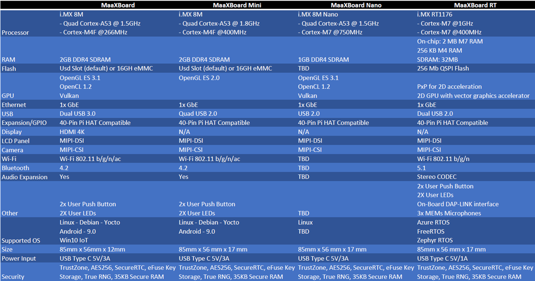

How exactly is MaaXBoard Mini different than MaaXBoard?
As mentioned before, MaaXBoard Mini is nearly identical to MaaXBoard, except that it's a bit faster, a tad more power hungry, and it has 2 additional USB ports instead of an HDMI display port. Additionally, the latest addition to the MaaXBoard family, MaaXBoard Nano was just released last week, and MaaXBoard RT, which was launched for pre-order this week!
Here's a chart comparing all four boards side by side:
