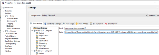

Select this package: Windows (mingw-w64-i686) hosted cross compilers -> AArch32 target with hard float (arm-none-linux-gnueabihf).
Unzip it on your development windows PC, running the extractor program as administrator (so that symbolic links are properly replicated).
Then: build and debug your first GCC 10 Arm program from Windows and Eclipse.

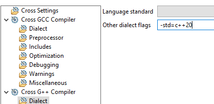

In G++ Dialect, enable the c++20 options
You can now compile c++20 programs for your Raspberry Pi, BeagleBone, ...

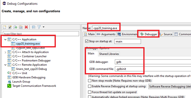

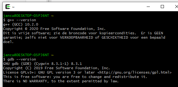

    Jan Cumps over 5 years ago in reply to Andrew J
    Most likely a GDB thing.
    Can you show your Run -> Debug Configurations -> Your Project -> Debug form?
    And in cygwin64 terminal:
    $ g++ --version
    $ gdb --version
    Here are mine:

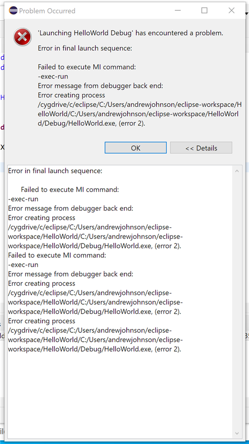

    Andrew J over 5 years ago
    Hi Jan Cumps
    slightly off-topic but I'm hoping you can help.  I've installed Eclipse 2020-09, with Cygwin64 and packaged gcc-core 10.2.0-1; gcc-g++ 10.2.0-1.  I have a very simple helloworld program which compiles and runs in Eclipse, outputting "hello world!" on the console.  When I try to debug this, I get a gdb error which I can't fathom
    The path looks strange to me so that's my suspicion but I can't work out (a) how it derived that; (b) how I can change it!  There's nothing that points to an issue in the debug configuration which points to the correct helloworld.exe.  Do you have any ideas?
    If I run gdb from the command line in the HelloWorld\Debug directory - gdb .\HelloWorld.exe - it works fine and I get "hello world!" output
