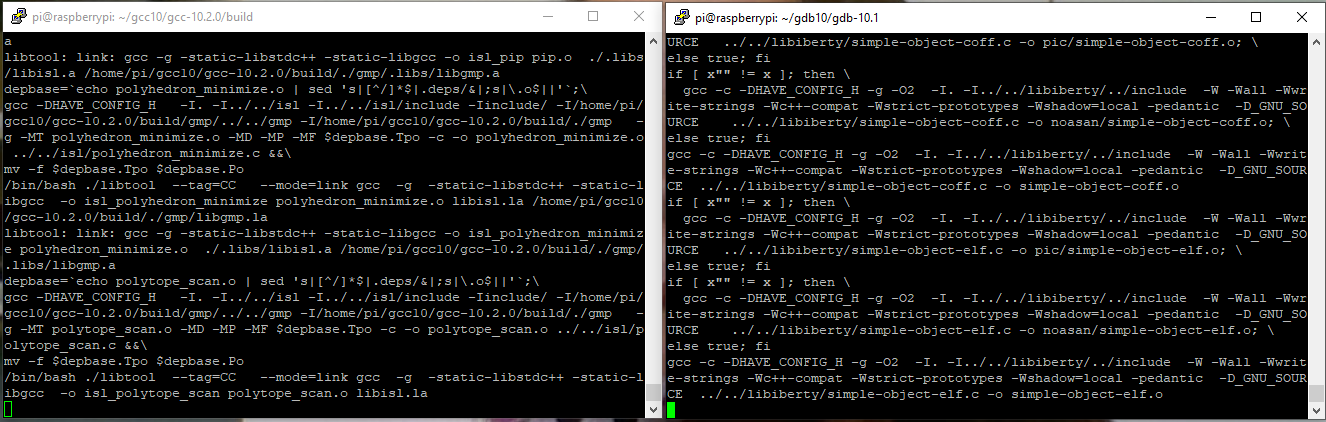

    Jan Cumps over 5 years ago
    Current status:
    building GCC and G++ from source on a Pi with a Fresh Raspberry OS install:

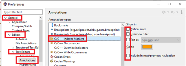

    Eclipse 2020-12 is not officially released. I witnessed some bugs:
    - the editor screen sometimes shows warnings and errors while the compilation and build is clean.
    - when debugging, at the end of the main program the debugger is somewhat confused if you step beyond the return().
    None of these impact the fun.
    Both of these aren't bugs.
    The first one is that some analysers aren't C++20 savvy yet:
    Question marks in the margin for valid code, that's the C++ indexer.
    If it annoys you, you can switch it of here:
    Bug icons in the margin for valid code, that's the Code Analyser.
    Again, can be culled here:
    The extra steps in the debugger when exiting main, may be the destructors being called.
    I'll check that. They always appear on objects that have been statically declared (without the new() operator).
    That's why I think the debugger jumps to the lines where they are declared. So you can step into the destructor.
