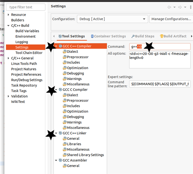

    When you use Eclipse on Ubuntu 20, you get the GCC version 9 by default.
    You can install GCC version 10 and set it as the preferred alternative, but Eclipse will still use the version 9.
    You can make it use version 10 by making these changes in the project's Properties:
    attach -10 after the commands.
    In the Dialect properties, manually enter -std=c++20 to enable the proposed new language constructs.
