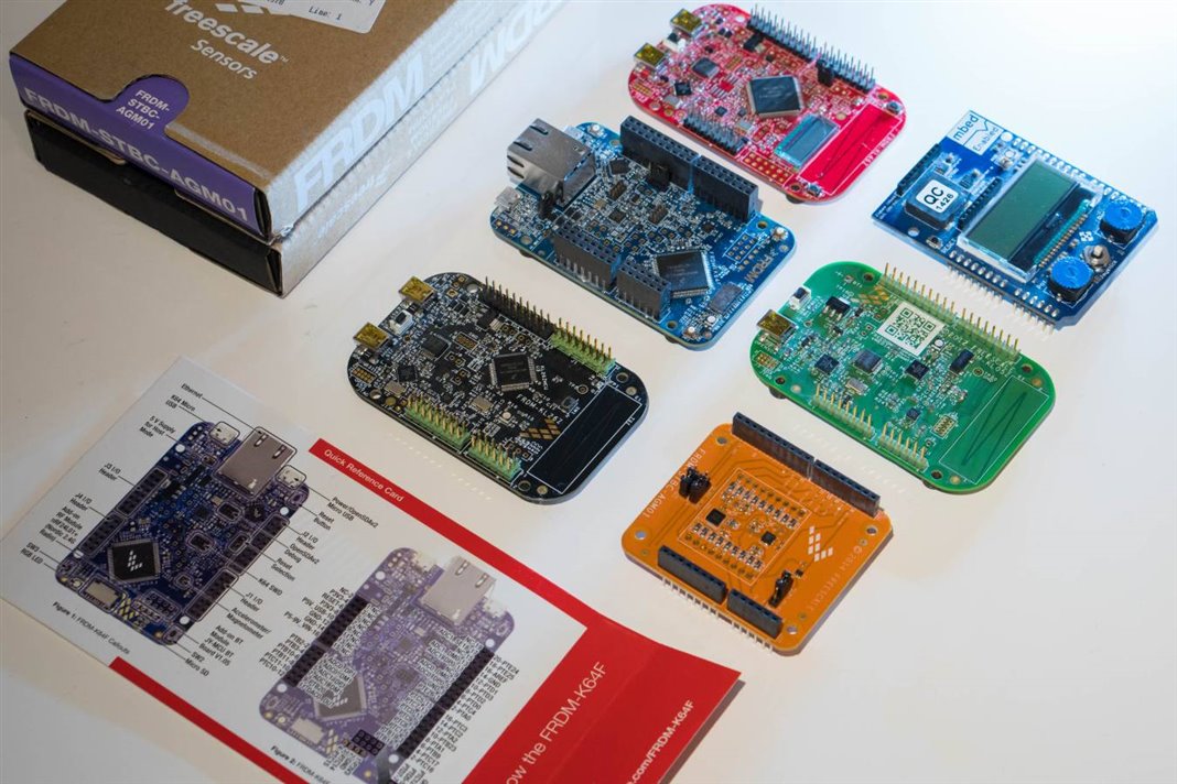

FRDM boards are a range of compact (slightly larger than credit-card sized) boards with a microcontroller. They are great for prototyping projects.
The FRDM boards and the mbed platform (described later) are designed to make users concentrate on coding their application, and not worry about intricate hardware or low-level driver code detail on day 1. It is about the smoothest experience for those interested in creating hardware and software projects.
In some ways it could be compared to Arduino. The Arduino project is also extremely popular; it allows people to rapidly create microcontroller-based projects. In the past, it was a fairly complex process to write code, compile it (i.e. translate it into machine instructions) and get it programmed into the microcontroller. With Arduino the process was greatly simplified and all the user needed to do was to download a single application for the PC, called the Arduino IDE (Interactive Development Environment), write the code there in a single file, and click a couple of buttons on the screen to build the code and program it into a low-cost Arduino board using a standard USB cable.
Although Arduino is still popular, there are also other exciting microcontroller boards out there and coding/compiling environments that are as easy or easier to use as the Arduino system. This blog post describes a coding/compiling environment called mbed, and as mentioned, the range of boards known as FRDM boards. The boards have a Kinetis microcontroller on them. Kinetis is the brand name of microcontroller chips made by NXP/Freescale, and they internally all contain an ARM Cortex based microcontroller core and some additional features. I love using these boards, I feel very productive with them and I thought it could be worthwhile to document how to use them.

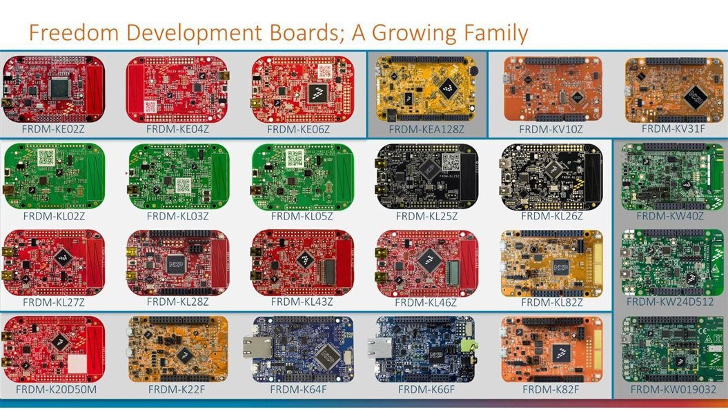

Kinetis Microcontroller Family and FRDM Board Introduction
Freescale’s (now NXP) Kinetis microcontroller series is based around the popular ARM Cortex-M range of cores along with Flash and data memory and integrated peripherals all wrapped up as a low-cost integrated circuit. The Kinetis series is nice because of the wealth of documentation (Motorola Semiconductor which became Freescale always had comprehensive documentation and the philosophy has been followed through over the years), and also because of the ease-of-use and very low cost to get started using the FRDM board range. I also like that the integrated peripherals inside the microcontrollers have Motorola heritage; it is apparent from some register names that some integrated peripheral designs were translated from earlier Motorola microcontrollers so if one is familiar with those then the learning curve is naturally lower with Kinetis.
The range is very good and it is actually fun to use these devices to solve problems. Perhaps the one to start off with is the FRDM-KL25ZFRDM-KL25Z because that is the first FRDM board that was released, and a lot has been written about it online. It has 128kbytes flash memory, 16kbyte of RAM and a Cortex-M0+ core running at 48MHz.
An ultra-high performance board is the FRDM-K64FFRDM-K64F, with 1Mbyte of flash memory, 256kbyte RAM and a 120MHz Cortex-M4 core.

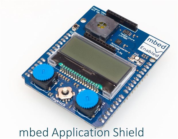

There is also an mbed Application Shieldmbed Application Shield available which contains a display, small joystick and several sensors. I tried it with the  FRDM-K64FFRDM-K64F board but it would work with other boards too.
There are plenty of other models in the series and it just keeps growing. In the diagram below, the entire range is split up into a few categories each with their own strengths and benefits. The diagram is possibly already outdated; new interesting FRDM boards come out all the time it seems.
The designers of the range have taken the effort to introduce different sensors and connections on each FRDM board so that the user can explore beyond just the microcontroller The  FRDM-K64FFRDM-K64F for instance has an on-board accelerometer and magnetometer IC. Some of the FRDM boards have a built-in 4-digit LCD.
(Note: Not all FRDM boards are supported with the online mbed platform, so if you definitely wish to use mbed, confirm by examining the mbed website Boards page and check the Target vendor NXP Semiconductors selection on the left to make it easier to search. If the desired FRDM board is present then it is supported! If it is not present, then a conventional local compiler will need to be used).

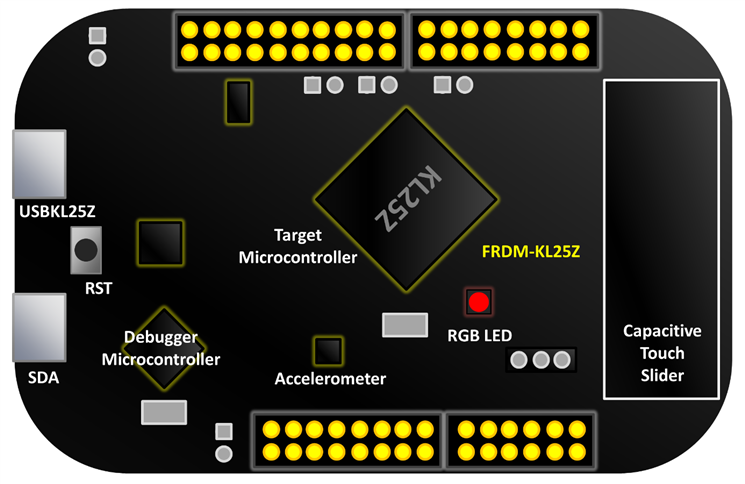

How do the Boards Work?

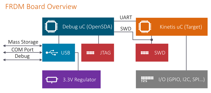

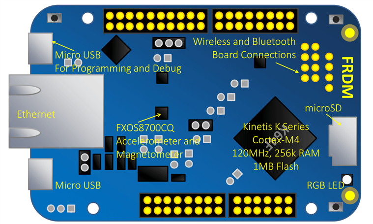

Each FRDM board actually contains two microcontrollers. One is the target device where the applications you create will run. It is shown in orange in the diagram below. The other microcontroller (shown in dark blue) behaves as a debugger/programmer. It connects via USB to the PC, and can program the target device.
No additional power supply is needed to run the FRDM board; power is derived from the USB 5V source, although if desired, once the board has been programmed, the USB connection is unnecessary and power can be supplied using pins on the board.
The diagram here shows the typical base functionality on all FRDM boards. Most boards will have extras too, such as on-board LEDs, switches, touch sensors and so on. This is great because it means no soldering is needed for experimentation. One can directly start coding and have input/output using the on-board devices, until extra hardware is connected up to the input/output (I/O) pins.
The Kinetis microcontrollers have some pins that are used for debugging and programming; they are often used in a mode called Serial Wire Debug (SWD). If the microcontroller was used in production equipment, then an external programmer would connect to the SWD pins and program the chip as part of the production process. With the FRDM board, there is no need to have an external programmer because the debugger microcontroller on-board (shown in dark blue) is used to manipulate the SWD pins for programming and debug purposes.
The USB port is used to transfer compiled code from the PC to the blue microcontroller. It then toggles the SWD pins appropriately to load the code into the target microcontroller’s flash memory.
Many microcontrollers have UART pins; these are great for connecting to a PC for control purposes. With FRDM boards, the UART pins are by default connected to the debugger microcontroller so that the data can be passed through the same USB connector. When the USB connection is made to the PC, several virtual connections are made and one of these looks like a communications (COM) port. So, your application code on the orange target microcontroller could have print statements that send the text via the UART through to the PC, using the USB connection.
To install a program into the flash memory of the target microcontroller, all that is needed is a drag-and-drop operation from the PC file system into the USB mass storage device that appears when the USB connection is plugged in. In other words, the FRDM board also looks like a memory stick to the PC, and you can just place the compiled code there. The debugger will take the code, and program it into the target device automatically, using the SWD pins.

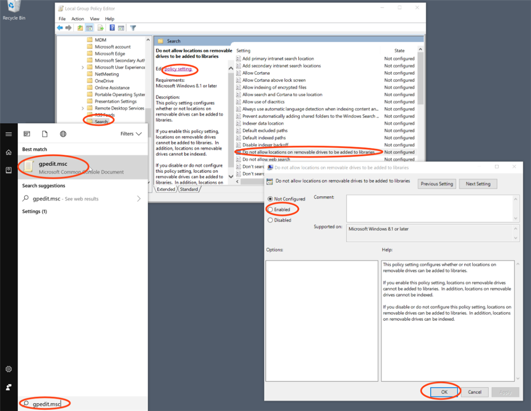

Extra steps for recent Windows versions (Version 8 upward)
The steps are detailed in the screenshots below. Follow these steps, and continue with the upgrade, and once you’re done, you can undo these steps to get the PC back to its normal state.

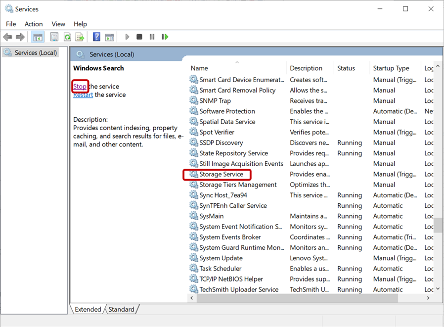

Basically, click on the Windows Start icon, and type gpedit.msc and launch that application. In the left pane of the application, scroll down to Computer Configuration -> Administrative Templates -> Windows Components -> Search and then in the right pane select Do not allow locations on removable drives to be added to libraries and click on Edit policy setting. Enable it, and click on OK.
Next, for the latest Windows 10 releases you will also need to disable the Storage Service. To do that, click on the Windows start bar, and type 'services' to select the Services tool. Within that, search for Storage Service and then click on Stop as shown in the screenshot below.

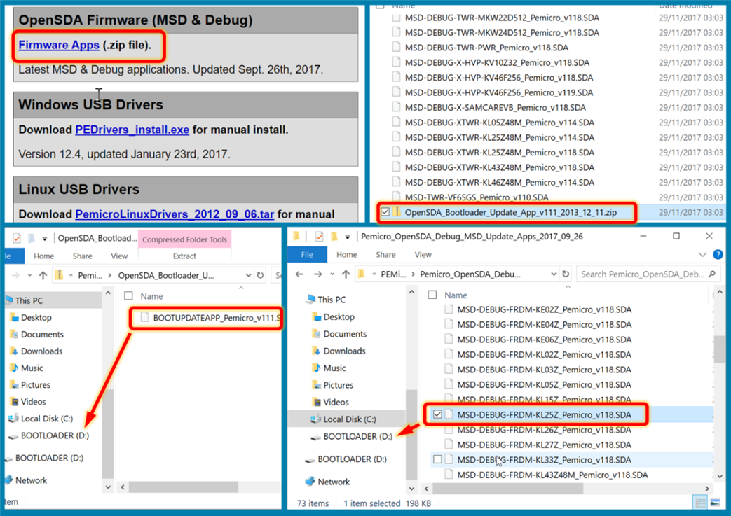

  1. Go to the PE micro website and download the OpenSDA Firmware (MSD & Debug) 'Firmware Apps' zip file (you will need to either register, or supply an e-mail address to get a one-time download link to the firmware bundle)
  2. Unzip it, and also unzip the ‘OpenSDA Bootloader Update App’ zip file that is within the first zip file.
  3. Hold down the Reset button on the FRDM board and plug the board to the PC. There are two USB sockets on the FRDM board. You need to use the one marked ‘SDA’. Release the button. The board should appear on the PC as a USB memory drive titled ‘BOOTLOADER’.
  4. In the extracted and unzipped files, find the file titled ‘BOOTUPDATEAPP_Pemicro’. Drag that to the memory drive. Wait a few seconds for the transfer to complete, wait ten seconds more for good luck, then unplug and re-plug the FRDM board into the PC. No need to use the Reset button this time, it is not needed from now on. The board should appear as BOOTLOADER again.
  5. In the extracted and unzipped files, find the file titled ‘MSD-DEBUG-FRDM-KL25Z_Pemicro’. There are many with near-similar names so it is important to find the one that explicitly has FRDM and KL25Z (or whatever the name of your FRDM board is!) in the title.  Drag that to the USB memory drive. Wait a few seconds for the transfer to complete, then wait ten seconds more just to be certain it is all programmed..
  6. Unplug and re-plug the FRDM board into the PC. The board should now appear as a USB memory drive with the name MBED or FRDM-KL25ZFRDM-KL25Z and not 'BOOTLOADER'. The upgrade process is complete!

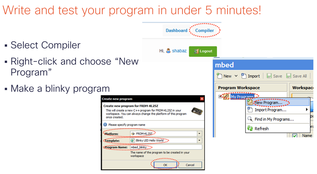

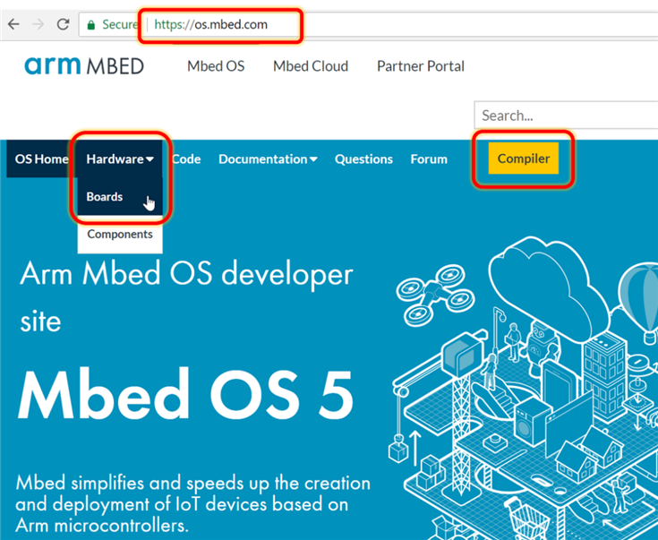

Working with the Online Tools

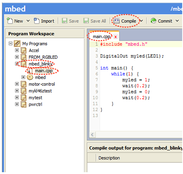

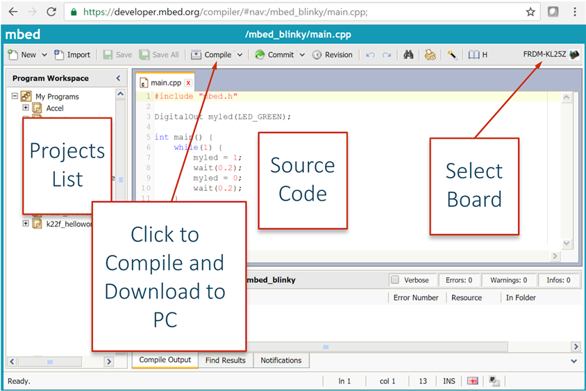

Go to os.mbed.com and set up an account, and then in the top menu select Hardware -> Boards and find the NXP  FRDM-KL25ZFRDM-KL25Z board. Click on it to bring up an entire page about the board and then look on the right side about half-way down the web page for an orange button with the text 'Add to your mbed Compiler’ and click on that too.
Next in the top menu select ‘Compiler’ to bring up a complete development environment in your web browser.
The development environment looks like this:
To create a new program, click on New and in the New Program pop-up window select the  FRDM-KL25ZFRDM-KL25Z board to be the platform, leave the Template at the default ('Blinky LED Hello World') and if you like, change the Program Name to whatever you fancy.
In the source code pane you’ll see a main.cpp file. Double-click on it to open it, and there will be a short program there that blinks an LED. If you click on Compile then the software will be built and automatically downloaded to your PC file system as a file called mbed_my_program_name_KL25Z.bin.
You can test it by dragging it over the USB memory if the FRDM board is plugged in. After a few seconds the software will be transferred and will automatically start running on the FRDM board. This demo program will make the RGB LED on the board blink red. The code is now in Flash memory and so unplugging and re-plugging the board into the PC will retain the code and the LED will continue to flash. Changing the program on the board is simple, just drag another file onto the USB memory file system.

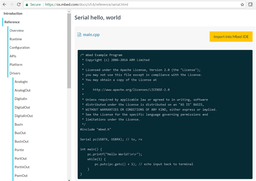

Features and Documentation
The functionality available in mbed is excellent, and the mbed documentation  is really good too. Some of the functions have similar names to Arduino functions like DigitalIn and DigitalOut, so for those already familiar with Arduino, coding with mbed should be fairly smooth.

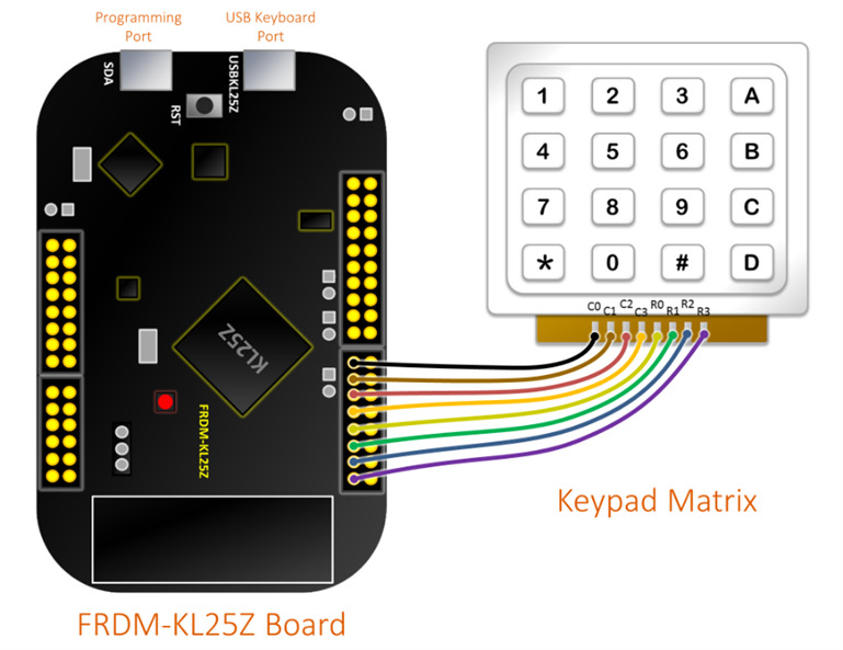

An Example Project
For a complete project with source code, one example is the USB keypad project. It uses a single component (a 4x4 keypad4x4 keypad) and eight wires, to make the shortcut keypad for PCs. It could come in handy when using CAD software packages with many shortcuts.

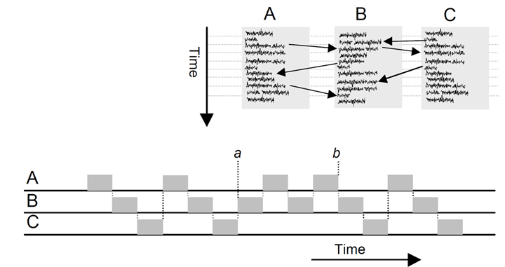

Advanced Use: mbed real-time operating system (RTOS)
Besides providing friendly APIs that make creating diverse applications easy, there is also real-time operating system (RTOS) functionality within mbed which greatly expands program structure possibilities and allows for users to simplify complex applications and allow them to run reliably. The OS allows for application tasks to be split into separate bits of code that can run whenever CPU capacity and other resources are available. Often in microcontroller projects there is the temptation to write everything in one large loop which can work fine but becomes very complicated quickly. Code can be untangled into separate processes or tasks using a real-time operating system.
The OS within mbed is based on Keil RTX and it appears to be free to use for all personal and commercial applications although this is worth confirming with ARM for commercial scenarios.
The diagram here shows just a small taste of the capabilities that can be enabled by using an OS for applications. Here a large single-loop program has been split up into three smaller tasks called A, B and C. The arrows show dependencies where each task needs to rely on sending or receiving information to another process. As an example process A might read analog sensor values, process B may filter them for noise, and process C could send sensor data to the cloud.
The horizontal execution flow shows that each process gets a portion of CPU time to run and then the next process gets some time and so on. However if there is noise in the sensor data then the data could be filtered out and there would be no need to send the noisy data to the cloud to conserve resources. It can be seen at the point marked ‘a’ that process C halts and waits during the period that perhaps noisy data is being filtered out. Only after an event at point ‘b’ does process C become ready again to run when it receives some CPU time.

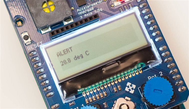

It was decided to try out the mbed OS task handling capability. Using the  FRDM-K64FFRDM-K64F board and the mbed Application Shield, a short program was written that measured the temperature every second and averaged it. If the average changes by more than +-5% then an alert is activated. The program displays the temperature every second on the display but only issues an Alert message if the average exceeds the threshold. This program was created as two tasks. The first task is responsible for obtaining the temperature measurements and calculating the average. If the average differs from the limits then it sends a signal to a second task.
The second task sits and waits (i.e. consumes no resources) until it receives the signal from the first task. The second task is responsible for issuing the alert.
The averaging settings and temperature and alert display times can all be varied as desired; this is a level of flexibility that would be awkward to achieve in a single thread of execution. The code below exercises thread creation, signals and mutual exclusion (mutex) functionality.
