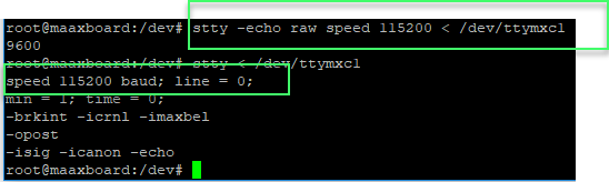

Hello!
I want to set the default baudrate of the /dev/ttymxc1. So i can handle it as a normal file with code. Where can i set it? I'm using the provided image from here: https://www.element14.com/community/community/designcenter/single-board-computers/maaxboard

    Hi David, It looks like the default UART baud rate for ttymxc1 is actually set to 9600. You can confirm this on your setup by running stty < /dev/ttymxc1 In the future if you need to change the defaul…

    Hi,
    Is there a reason you want to change the baud rate from the default 115200? Are you trying to use it with some peripheral? can you elaborate please.

    david.bozo over 5 years ago in reply to jafoste4
    Yes i want to communicate with a peripheral. It is using 9600. And that peripheral has a closed source code so i cant change that.

    jafoste4 over 5 years ago in reply to david.bozo
    Hi David,
    In the future if you need to change the defaul uart baud rate you can do it such as the following. (I set ttymxc1 to 115200)
    Let me know if this answers your question.
    Thx,
    Josh
    Thank you! It works nicely.
