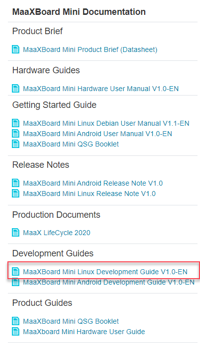

    Hi Marco,
    We are working on a perminante solution to allow public access to this file instead of it being in the interal gitlab. In the mean time, please download all the source files here https://www.dropbox.com/sh/nun0hxth4muf6qv/AADS9GPt2A5EyGAM8GS-bKqPa/02Linux%20Debian/01LinuxSourceCode?dl=0&subfolder_n…
    And follow the Debian Development Guide for the MaaXBoard Mini MaaXBoard -> Technical documents tab
