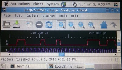

    bwelsby over 13 years ago in reply to e14 Contributor
    selsinork wrote:
    Brian Welsby wrote:
    I think a user interface re-write is needed for low resolution LCD usability though.
    That's probably common to just about everything. It always annoys me when assumptions are made that forces whatever button you need to click off-screen, there's no keyboard shortcut and they've pointlessly, but deliberately made the window or dialog box non-resizable.
    One trick that sometimes works is to try to force the system to use a smaller default font to get buttons back on-screen, but that definately doesn't help small screen useability
    The photo below is the client running on an LCD4.  This is with a "Test Device" selected.

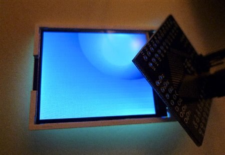

    shabaz over 13 years ago in reply to bwelsby
    That's great, seeing OBLS on the LCD. I suppose the code could be reworked to use on-board buttons if desired rather than touching through the menus too. Another idea is to have a rotary encoder that apps are able to use to perform the action in context, e.g. scroll left/right in OBLS, unless (say) a button was pressed to go into zoom mode.
    The link you posted (about interfacing LCDs through HDMI) is interesting too, I'd still been working on trying to interface the large LCD throgh PRU by serializing the data. I haven't got very far yet, waiting on some ICs.
    I got a bit further with the 1.8" LCD (ideal for status displays on smaller instruments, etc), and basically the PRU now waits for a 'graphics' instruction from the ARM-hosted app (a single byte instruction using shared mem), and currently it recognises just one command, which is to fill the screen based on a buffer of RAM that is populated by the application, as shown here.
    The buffer is 80kbyte currently because I've not taken any effort to pack 16-bit pixels better (it could be reduced to 40kbyte).
    However, although the PRU can access the entire address space, since the app has virtual address space, I need to have some pre-allocated fixed chunk of memory (that I can mmap), and there is such an area, but it's not much (and I couldn't figure out how to increase it, perhaps it's another device tree parameter). So, for now, I just write to the screen split into 8 smaller chunks and have some handshaking using the single byte. It works fast anyway.
    The very unoptimized code currently takes a cairo drawn buffer, converts to the buffer used by the LCD, and then sends the 8 chunks. The cairo rendering of the shaded spheres and background in the photo is near-instantaneous, and that plus the sending of the chunks all occurs in less than a tenth of a second at a guess, and most of that time is the sending of the 8 chunks. So, I can't do video until I can learn to resize the memory, but I'm not very interested in that anyway.
    More interesting would be to add some more graphics instructions to the PRU, for (say) sending a smaller image-fill to only a portion of the screen, or to draw basic boxes and text (I don't want to spend too much time on it, because there is only so much a tiny LCD is good for). I'll tidy the code a bit and post it in a day or two. (by the way I used the 27th May image, and enabling the PRU via the fragment .dtbo work first time - so hopefully this is more reliable in this build, although I didn't reattempt).

    e14 Contributor over 13 years ago in reply to bwelsby
    Really nice to see it working, shame about the silly big icons and all the other wasted screen space. Legacy of assuming 'desktop' and a relatively large display.
    What's needed is a physically small but still high resolution display, sadly those aren't common with useable interfaces - as that person on the hipstercircuits.com blog found out.
  • bwelsby
    Yes, but at the moment only half working. The openjdk packaged for Angstrom has some issues so I am leaving that for now and seeing if Debian, Ubuntu or Arch are better.
    It is possible to hide the X top and bottom bars and reduce font sizes which gives a more usable display but as you say a higher resolution would be better, they do exist but are quite expensive.
