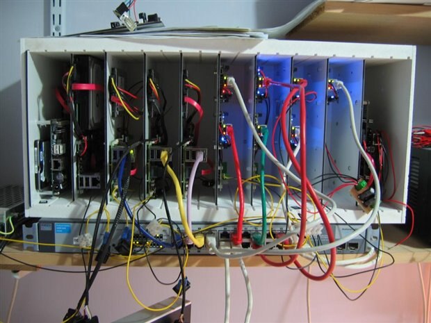

    Been a while since I posted any pics of this, but the collection is growing, I'll be needing to build the expansion soon image

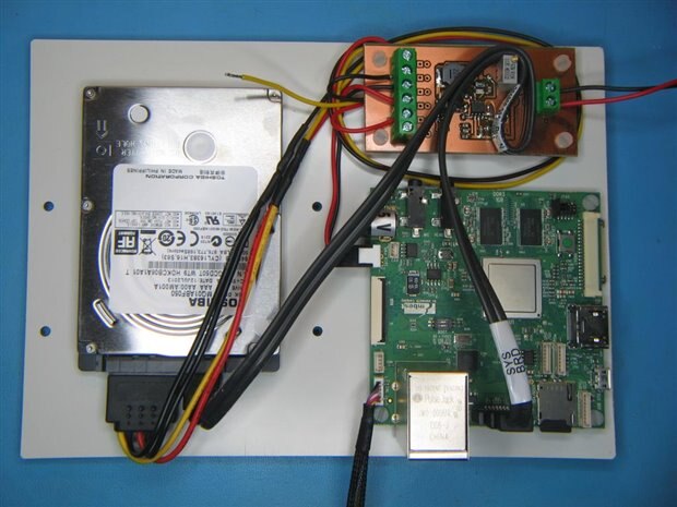

    Each carrier looks something like this:
