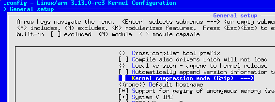

    e14 Contributor over 12 years ago in reply to e14 Contributor
    Your Kernel Compression mode is set to LZO but you don't have the proper tools installed
    In menuconfig, go to General Setup and change it back to Gzip:
    Alternatively, the lzop source is available here http://www.lzop.org/
