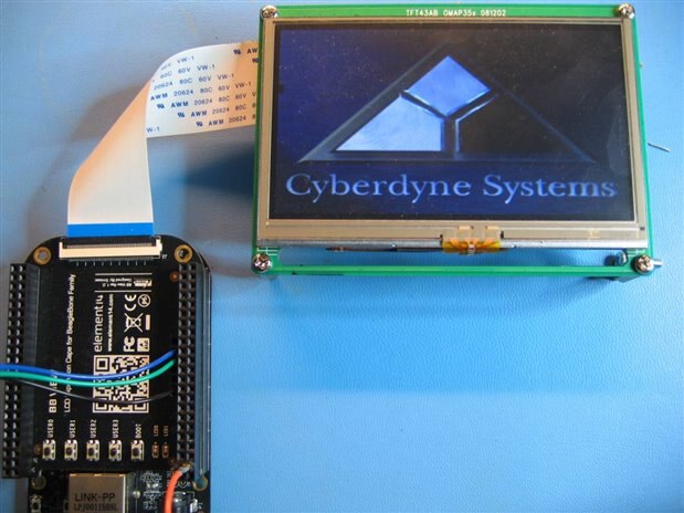

Reboot the BBB and the LCD should now work....except the blue and red are reversed.
Fixing Red/Blue Color Swap
This is due to errata in the TI AM335x processor when switching between 16 and 24 bit video modes. To fix this, we must first find the name of our screen:

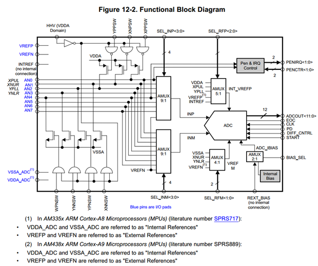

    Hello selsinork, "Which kernel version are you using ?" I use the 3.8. "Did you apply the patch Louis posted ?" I rebuild the kernel with Louis' edits in the "4. Re:[How-to] BB-View on latest Debian" message…
    e14 Contributor over 12 years ago in reply to e14 Contributor +1
    Ok, so with the overlay loaded then the touch screen driver should be able to work. You can check the proper device using 'evtest' like this: root@lcd:~/evtest# ./evtest No device specified, trying to…
    Interesting. I seem to remember that one of the LEDs on the cape was configured as heartbeat. Perhaps that was the TI-SDK image then as looking at the overlay files I see: gpio-leds-cape-lcd { compatible…
    Perfect timing, I was just about to start looking for what pieces I need to extract in order to get the 4.3" BB-View working on a vanilla 3.13 kernel. Looks like you've identified the interesting pieces for me image
    When you say the touch screen is different from the standard TI 4 wire interface, how did you work that out ?  Did you find schematics for the BB-View anywhere ?
    From the Angstrom source download, a diff between BB-BONE-LCD4-01-00A1.dts & BB-VIEW-LCD4-01-00A0.dts is interesting, there's a couple of differences in the pins used for LEDs & keys along with differences in numbers of leds & keys.
    Other than that, there's one extra pin used for "LCD DISEN" in BB-BONE-LCD4-01-00A1.dts and for the BB-VIEW there's this
    ti,touch-type = <1>;
    in the LCD7 ones the BB-VIEW has that as 2
    Not exactly sure what that does just yet, but it's obviously some hint to the driver to configure something a certain way. Otherwise the driver and pins used appear to be identical.  Perhaps it's a place to start looking for the problem though.

    Well, the recompile seems unavoidable due to the way the charge bits are used. I have made changes to the stock touchscreen drivers, to add a hook for the BB-View, but also to keep compatibility with other displays. I will see if I can get someone to include them in the next kernel patch.
    For some reason, the xinput_calibrator is not working properly with the values being returned by the tsc. Manually modify your /etc/pointercal.xinput file, on the bbb, to the following, to get it close:
    xinput set-int-prop "ti-tsc" "Evdev Axis Calibration" 32 3953 130 366 3832; xinput set-int-prop "ti-tsc" "Evdev Axes Swap" 8 1;

    After what seems like way too long fighting with devicetree... It's alive !
    ts_calibrate is of course giving me a pile of crap, so your patches to the touchscreen driver are next on the list.
    I should also say here that I'm not using the beaglebone kernels, I'm using mainline.. Gave up with the mess that's going into the beagle kernels a while ago.
    The TI folks doing the mainline devicetree development for am3359 (and omap in general) and the beagleboard folks are heading off in two totally different directions, the differences are significant at this point.
  • compeoree
    compeoree over 12 years ago in reply to e14 Contributor
    Very good. Just curious if you boot up in the proper color mode, or if you wait until X starts up like I do?
    e14 Contributor over 12 years ago in reply to compeoree
    I don't have X installed, the tux logo has correct colours and that's just a jpg displayed with http://repo.or.cz/w/fbv.git
    I'd like to say I did something interesting to make it so, but I've not knowingly done so.

    Yeah, I think we need to know more about the low levels of the touch screen controller in the AM335x processors, in order to make the patch more universal.....see if this helps:
    Taken from the AM335x Technical Reference Manual.
