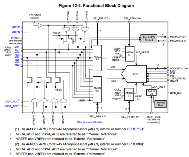

  • compeoree
    compeoree over 12 years ago in reply to e14 Contributor
    I thought so too, but I tried several permutations over two days, and still could not get it to work. But, at the time, I did not realize that there was a bug in xinput_calibrator, so that may have been some of the problems that I was seeing.
  • compeoree
    I think my initial guess was using 00, 25, 14, 33 for the wires config. With the 4 and 5 being STEPCONFIG_XNP and STEPCONFIG_YPN added to the config_pins array at the beginning of ti_am335x_tsc.c
    I may have to test it again, now that I know about xinput_calibrator having trouble with inverted axis
    e14 Contributor over 12 years ago in reply to compeoree
    hmm.. bugs are never a good thing, especially when you're trying to work out why something isn't working image
    I don't understand the code well enough yet and my current results are only showing up/down touch moving the point left/right and no reaction to left/right touch from what I can tell.
    So I'm going to try your patch exactly as-is and see what happens.
    e14 Contributor over 12 years ago in reply to e14 Contributor
    Well it works perfectly!
    Now I just need to try and understand how it all works..  I may be some time image
  • compeoree
    Very good!
    Yeah, I think we need to know more about the low levels of the touch screen controller in the AM335x processors, in order to make the patch more universal.....see if this helps:
    Taken from the AM335x Technical Reference Manual.
