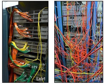

    Hi Mark, I think you're right, good as a general tool, not for commercial installers. I've been in some awful locations where people have been stepping on cables, wires are strung across racks etc. (so…
    e14 Contributor over 12 years ago in reply to shabaz +1
    they usually start off like the first photo, but it takes discipline to keep them that way. I have a colleague whos purpose in life is to make the second photo seem neat

    I think you're right, good as a general tool, not for commercial installers. I've been in some awful locations where people have been stepping on cables, wires are strung across racks etc. (so bad I had to take a photo - see below), so here such a tool would have saved a lot of time and headache! : ) For me this was the worst I'd ever seen : )

    image  they usually start off like the first photo, but it takes discipline to keep them that way.  I have a colleague whos purpose in life is to make the second photo seem neat image
